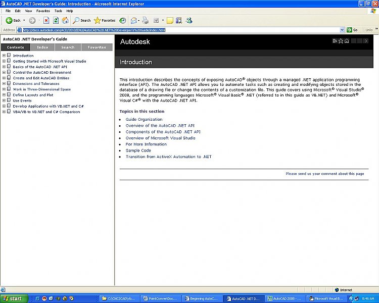

Have you seen this? I have not looked at it yet, but thought I'd send it your way just in case...
I can not post website links, but if you will google:
"AutoCAD vb net developers guide" you should find some help.
Whether it is good help or not, is another question.
Here is a screenshot of the AutoDesk Develops guide I found...
Hi,
You can find on this page some usefull downloads :
ObjectARX : which contains chm files and some .NET samples
Introduction to AutoCAD .NET Programming : a video
AutoCAD .NET labs : a tutorial
AutoCAD .NET wizards : a wizard which adds a new Model to Visual Studio
AutoCAD .NET developer's Guide : mentioned above
You can also use DotNetARX which is heplfull to strat a new AutoCAD .NET project (download the Express version).
But if you're new to .NET, before trying to program AutoCAD you should learn Visual Studio and .NET basics (there're many tutorials, forums, books about this).
