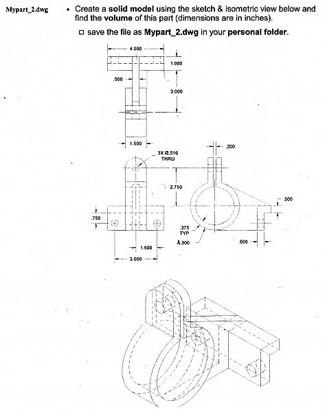

super Posted February 19, 2010 Posted February 19, 2010 Hi, I'm having trouble creating this model. Any help would be greatly appreciated! Thanks. Quote
Crazy J Posted February 19, 2010 Posted February 19, 2010 Hey, I thought I'd give this a try. The main block on the back with the lip. It's given as 4.00 x 1.00 x ? in the view on the top of the page. Maybe I am missing it in the resolution of the jpg. Quote
Crazy J Posted February 19, 2010 Posted February 19, 2010 what's the number under the .375 thickness of the tube section? Hard to read. Does anyone know if I can detach jpgs and then be able to zoom in on them on my own machine? Quote

super Posted February 19, 2010 Author Posted February 19, 2010 Hi, this should be any number, such as 2.5. Quote

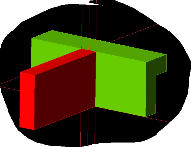

Crazy J Posted February 19, 2010 Posted February 19, 2010 A rectangle, extrude, xl (construction line), imprint (now Presspull in newer versions), another extrude... that's all the green. Then some more centerlines (xl's) in red, a rectangle extruded forward. From the corner of the red rectangle, I will draw a circle and extrude on way, and then a solidedit extrude the other way to the proper total length of the collar. Next, hollow that out to the proper thickness, probably with a smaller circle extruded through the length. This time I would start on one end rather than the middle to save the two step process it took me to draw the outer diameter. I can't see the picture now, but then start on some features for where the clamping bolt goes through. First thought is to use a slice command, but then I would have a slice all the way through the bottom of the now hollow cylinder. Instead, I might create some more construction lines and then draw a box (or rec. extruded into a box) in the position of where the cut will be. Subtract that from the model. Then you have a couple more holes to put in. Which you should have that figured out if you've made it this far. And then adding the rest of the web. My guess is that I would go to my side view and do some more xl's and then perhaps trace it all with a pline (command: pl) and extrude that to the thickness desired. Then do a final union command to join all the pieces into one, and I think you should have it.... Let me know how it goes... It's not letting me post the picture... hold on. Quote

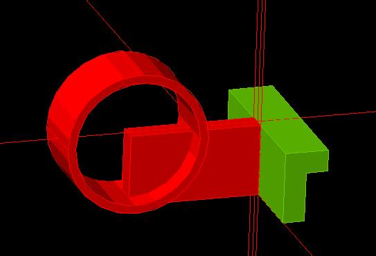

Crazy J Posted February 19, 2010 Posted February 19, 2010 It's not letting me post the picture... hold on. Here's the picture now, it let me do it this time. Quote
Crazy J Posted February 19, 2010 Posted February 19, 2010 Hi, this should be any number, such as 2.5. I estimated 1.625 and that is what shows in pic in previous post. Quote
Crazy J Posted February 19, 2010 Posted February 19, 2010 And from the 1.625, I then came up with a dimension for the tube... Here's another view, but if this is your homework, then let's see how you're coming along with it before I post any more.... Quote
