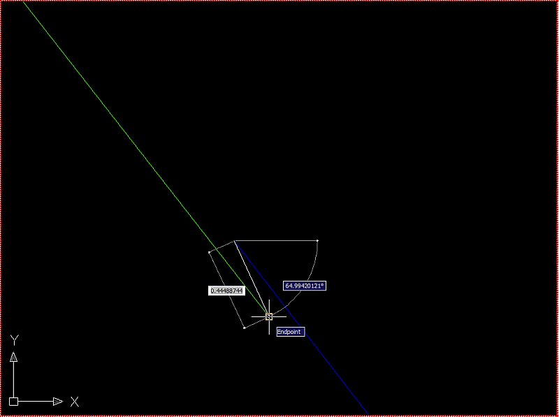

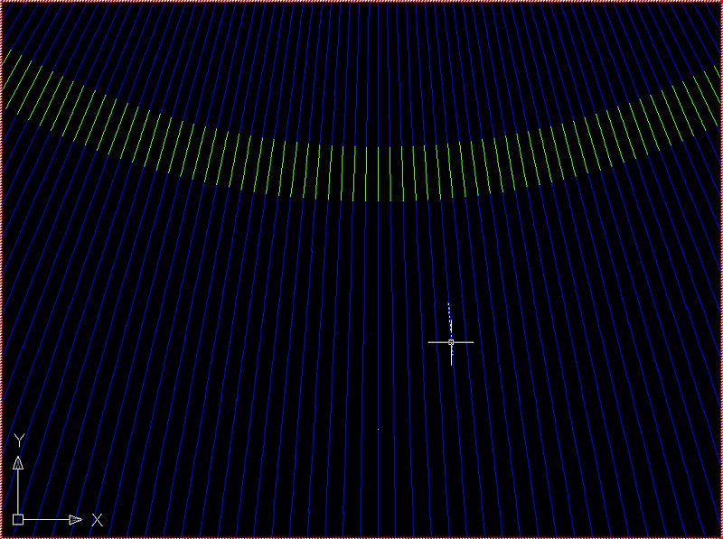

Basically what I have is a series of polar arrays, which do not line up just right. On similar things I was using Object Snap and connecting the lines with the mouse, but now with so many lines that would take at least 22 hours to adjust everything.
Can someone please help me write a little macro or something to make this job a bit easier? Basically what it would need to do is start at the bottom and adjust each upper row to connect on the corresponding endpoints of the next array.
  • I have included a few screen shots of what my arrays look like. Each individual line is 111.11111111mm, and you can see that I changed one of the arrays to green for visual clarity.
  • The second image is an example of the misalignment of the ray endpoints on a greater magnification. The differences range from less than half a millimeter to a few more than 10 mm. I used the line tool to draw a rubber band between two of the endpoints that need to be connected for visual clarity. The rubber-band is not a permanent line, just a visual aid to show the discrepancy.

I'm not sure if that is possible because I have the precision setting maxed out. This seems to be the closest that the CAD program can line them up. Another problem is that the arrays don't follow perfect arcs after they are in place.

Delete them all except one set of blue-green-blue.
Use grips to get the ends of these three lines together and then polar array them to get back to what you had but with the line ends co-incident.

The third line (the rubber band one) is just to help visualize the misalignment. Since the arrays don't follow a perfect arc, only the 2 outside lines actually align properly.
The screen shots should have all the necessary information. I believe that I need to somehow select each ray and then Object Snap its top endpoint to the bottom endpoint of the ray above it.

Found a couple of things the two arrayed objects have been created differently hence the mismatch the white has a radius of 14.1421 and the blue 14.4325 hence the gap varies across every single pair no simple soloution, personally in the time it has taken me to write this I would have redrawn them all!
Also checked as per the radius the angle of the lines is different I would ask the question before making a join what is the correct angular soloution as well.
