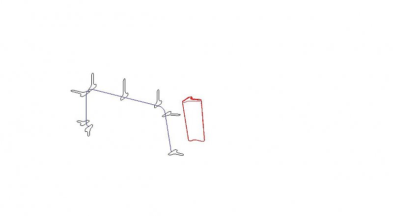

woodworks Posted February 15, 2010 Posted February 15, 2010 Having a problem lofting obljects with polyline guide in Autocad 2009. Message says selected entities are not valid. Could use a little help P09_04.dwg Thanks Quote
ReMark Posted February 16, 2010 Posted February 16, 2010 Woodworks: The problem is most likely related to the underlying geometry of the objects you are trying to loft. I exploded one of the objects and found that you had the end of one line extending over and beyond the end of a second line and that some of your lines were not parallel to the UCS they supposedly were created in. Bottom line is you did not pay attention to detail (i.e. - sloppy work). After correcting two of the eight profiles that are arrayed around the blue guide path I was able to loft them sucessfully. Go back and correct each profile and try again. Quote
ReMark Posted February 16, 2010 Posted February 16, 2010 Woodworks: Here's the proof. I took the two profiles on the right hand side of the guide path, editted their geometry and then lofted them (object in red). Quote

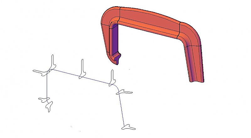

ReMark Posted February 16, 2010 Posted February 16, 2010 Woodworks: Just to prove it can be done here is the finished product. Notice that I lofted "sections" of the object. Quote
woodworks Posted February 17, 2010 Author Posted February 17, 2010 REMARK: After redrawing the objects I was able to loft each section. Actually it would loft from left to right almost the whole length. Not sure why it wouldn't make the last corner but I lofted the last section by itself and used union. I've been using cad to draw cabinets and millwork, 3d is really fun. Working my way through a textbook in my spare time. Appreciate your help Quote

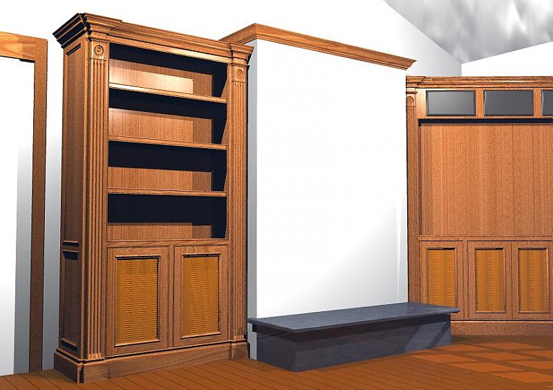

a1harps Posted February 24, 2010 Posted February 24, 2010 Since you didn't get a reply ReMark I can post a few shots of some millwork I drew. Quote

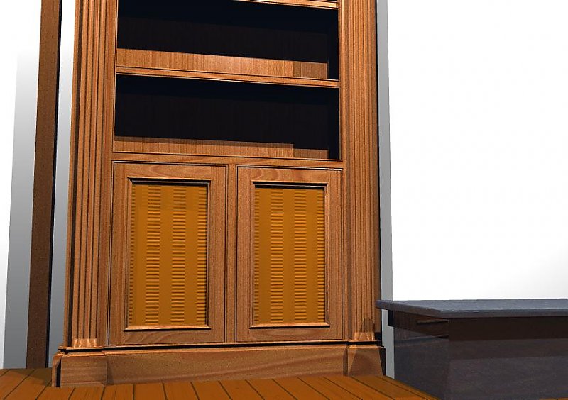

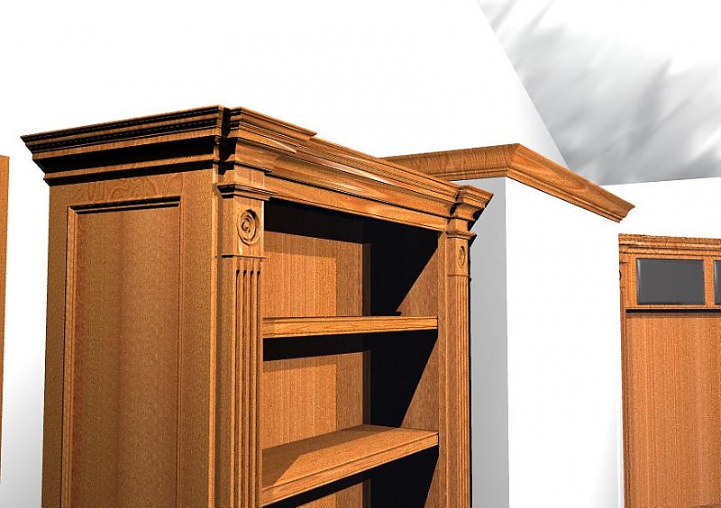

a1harps Posted February 24, 2010 Posted February 24, 2010 I build Furniture,Built-Ins & Architectural Millwork. These things all actually fall into the catogory of Architectural Millwork or Millwork from the contractors point of view. These drawings (rendered) are a design idea/proposal for a possible project. What AutoCad means for my work is actual replication in advance. What I mean by that is that there are a lot of "Drop & Drag" software programs on the market that contain generic moldings and other architectural components that can be used to render a "facsimile" of the actual end millwork product. I create my own moldings and grind my own molding cutters and rosette cutters etc. in house. Part of that process is to first draw the molding profiles with Autocad. When I design a project I am able to use solid objects that are accurate to .010" of what the actual product moldings etc will be. I don't think there are many like me who spend the time it takes to do this with Autocad. I am hoping it will pay off in the long run and get much faster. I recently (two weeks back) purchased Bryce and import my 3D models as 3DS files for rendering. I gotta say that I am liking rendering a lot better now that I have Bryce. It is much easier for me than trying to render in Autocad was. Quote

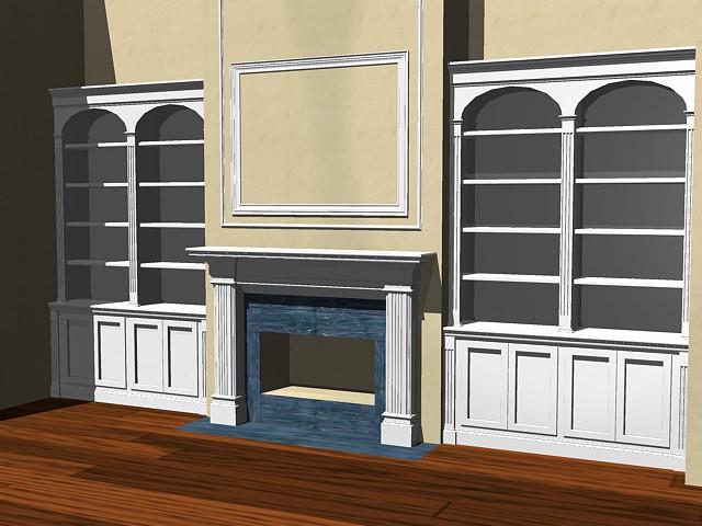

woodworks Posted February 24, 2010 Author Posted February 24, 2010 A1Harps, Very nice work. Had attached a drawing and received a reply. Started out doing cabinets and trim in custom homes 30 plus years ago. Last 6 years am working out of shop. I'm still learning / experimenting with AuotCad but here's a couple renderings of projects. Not familiar with how to post images so please see attachments. Remarks thanks again for your help Mohogany Render.pdf Copy of e Changing Table Final.pdf Quote

a1harps Posted February 24, 2010 Posted February 24, 2010 A1Harps, Very nice work. Had attached a drawing and received a reply. Started out doing cabinets and trim in custom homes 30 plus years ago. Last 6 years am working out of shop. I'm still learning / experimenting with AuotCad but here's a couple renderings of projects. Not familiar with how to post images so please see attachments. Remarks thanks again for your help Thankyou Woodworks, it is a comfort to know I am not the only woodworker out here drawing jobs with Autocad. Like you I am also learning to use this software but I am still hands on in the shop these days as well. The best thing I have learned about recently is Bryce 3D software for rendering. The software is only about $50.00 American and it was a night and day different for me when it came to rendering a solid model compared to rendering with Autocad. The three renderings above were all in the 18 to 21 minutes range of rendering times apiece. If I had to pinpoint the best difference I would say it is the lighting that is way easier to set up in Bryce. But really, the whole process is faster and easier for me to get a grip on. Your work looks very nice! To post a rendering on this forumor in emails etc...when you are in the Autocad rendering dialogue you need to choose the "Render To File" option. Choose a location(folder) to send and save the file to in your computer and then most importantly, save the drawing as a "JPEG". I noticed that bitmap files are too large to be accepted here but if you convert a bitmap to a JPEG it reduces the file size tremendously. Quote
