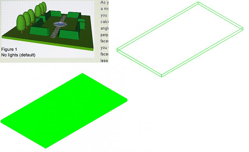

I'm running acad 2002
When I render, it looks terrible. I assumed that I need to learn about lights. However, the tutorial shows that the default with no lights. This looks very different from mine.
Is it because I'm running 2002 or is there a default setting I need to change?
is the last picture rendered?What is DEFAULTLIGHTING and LIGHTINGUNITS set to?
I typed in LIGHTINGUNITS in the command line. it returned
Unknown command "LIGHTINGUNITS". Press F1 for help.
Same with DEFAULTLIGHTING
looks like it's not available in acad 2002
Anyway, I did a bit more playing
view
shade
gouraud shaded
looks like what I want
