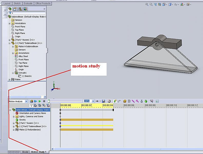

im not at work today so i dont have SW in front of me but go to this post and i put some screen shots of the motion study.
http://www.cadtutor.net/forum/showthread.php?t=31599&highlight=motion+study&page=2
post #13 is where the screen shots are. You can see im pointing to a cam mate. You will notice a few icons over is a green apple. This is how you turn on/off gravity. Tomorrow at work ill try to do a simple example.

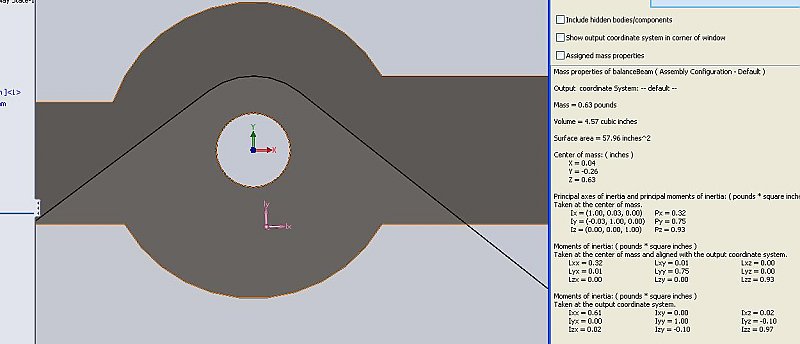

alright here is a quick vid and a few screen shots. This was a really basic example. First your "base" needs to be grounded and your assembly needs to be properly constrained for the motion you want. If you can move it in your Assembled model you need to handle that first.
ill have to explain the images a bit later for you.

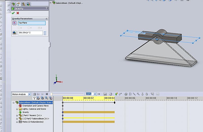

Alright so the first part is obviously a vid. The first image shows the location of my CG. I made sure it was just barely off to one side so i would get some motion but not a ton. The second image shows you the bottom of the screen next to your model tab is how you start a motion study. On my screen there is a drop down box that says Motion Analysis. When you first start you will need to change this to Motion Analysis or basic motion in order for the gravity to work.

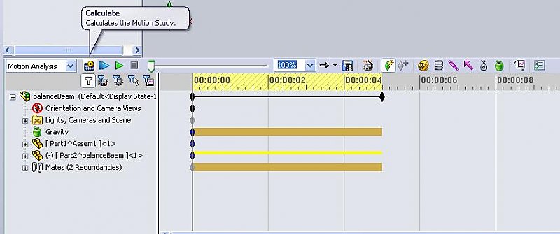

In the 3rd image I had just clicked on the Green apple icon to apply gravity and I selected my TOP plane as the reference. Pay attention to the plane and the arrow direction for this. The last step is to click calculate.
