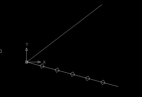

A question,
I am trying to set someone up with a command for the original macro:
^C^C_Select;\-array;p;;P;\\'Cal;ang(@,cur,cur);
The user has Autocad LT 2009. The macro runs, and I do the exact procedure which the animated GIF attached suggests you should do. However, when I select the second point, I get an error:
Requires valid numeric angle or second point.
The following is the output on the command line when running the command:
Select objects:
1 found
Select objects:
Enter the type of array [Rectangular/Polar] <R>: P
Specify center point of array or [base]:
Enter the number of items in the array: 5
Specify the angle to fill (+=ccw, -=cw) <360>: 'Cal
>>>> Expression: ang(@,cur,cur)
>>>> Enter a point:
>>>> Enter a point:
Resuming -ARRAY command.
Specify the angle to fill (+=ccw, -=cw) <360>: 5'-1-5/8"
Specify the angle to fill (+=ccw, -=cw) <360>: *Cancel*
Any help would be appreciated. Thanks.
Somehow the Cal command is misinterpreting the pick points. This line here shows that the Cal returning a linear measure:
Specify the angle to fill (+=ccw, -=cw) : 5'-1-5/8"
I originally suspected that some unit other than degrees was set, DegreesMinutesSeconds in particular. Though, here, that doesn’t seem to have any ill effect. Interestingly enough, I found that the macro will produce erroneous result with Radians and Gradians set for angular units. The macro does run to completion, it is just that the angles are wrong.
Perhaps it is a localization issue: Is the AutoCAD install set up to use a comma for the decimal point?
SEANT, Thanks for your reply. The user has their Angular Units set to Decimal Degrees, and they are not using a comma for the decimal point, or any other customized localization settings as far as we know.
Also, just to clarify further, When we get to the step where you enter the second point: we click the second point, we get the error stated above, and then autocad begins giving us a line from the center point of the array we specified (as if it is trying to measure or draw a line from the center point. We then click on final point, rotate objects, and the macro finishes, with the angle of arrayed objects incorrect.
I can’t reproduce the error.
Given that macros just script prompts and user input, what happens if the sequence of input is entered manually? The Command Line sequence for that process would look like this:
Command: -array
Select objects: 1 found
Select objects:
Enter the type of array [Rectangular/Polar] <R>: p
Enter the number of items in the array: 6
Specify the angle to fill (+=ccw, -=cw) <360>: 'cal
>>>> Expression: ang(cur,cur,cur)
>>>> Enter a point:
>>>> Enter a point:
>>>> Enter a point:
Specify the angle to fill (+=ccw, -=cw) <360>: 39.121046543005
Rotate arrayed objects? [Yes/No] <Y>: y

I am very happy to see the boards back online.
Ironically, when doing the command line procedure that SEANT outlined above, the procedure works perfectly.
I have my colleague using this macro:
 ^C^C_Select;\-array;p;;P;\\'Cal;ang(cur,cur,cur);
which works, you just have to manually enter @ when asked for this first point. My colleague is very happy with it, as it is far better than what he used to have to do to get the polar arrays to work. Apparently the macro we were trying would not give us the at sign (@) for the first point, even though it is supposed to automatically.
Thank you all for your help!
