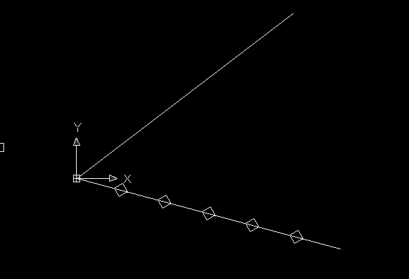

For the "angle to fill", that is the total span of the objects, so I believe you want to enter "90" or "91" for number of objects then "30" (for example) as the angle to fill. AutoCAD would calculate each object is spaced 30/90.
Thanks for your quick response, CarlB.
I actually have 90 Polar Arrays to make, and the 'Angle to Fill' could be anything from 90º to 30º. For instance, the first Array is elementary, since it is 90º and there are 91 rays. It gets trickier on the next angle though, because it is 89.33333333º, although I do not know what the other angles will be.
(Even though for this example, one could extrapolate a simple pattern of a -.6...º change for each new 'Angle to Fill', I have changed the range of angles in my drawing and so I need to find a better strategy.)
I believe the solution to this problem would be either a better understanding of the 'Pick Angle to Fill' button/prompt (and tool), which seems to be totally haywire - Or a way to measure the precise angle (0.00000000º) before starting the Array.
I tried to install this angle measurement routine: http://discussion.autodesk.com/forums/servlet/JiveServlet/download/247-649740-5872230-177931/AG_ADV.zip ), which I found at this site: http://discussion.autodesk.com/forums/message.jspa?messageID=5878369 ), but I was not able to get it working. The file contains a LISP, a DCL and an SLD, but I can't figure out how to get them to work.
I’m not sure if this is what you are investigating, but: This command macro acquires an angle similar to the Rotate by Reference for the Polar array command. The user interface is command line only – no dialog box.
See demo.
^C^C_Select;\-array;p;;P;\\'Cal;ang(@,cur,cur);

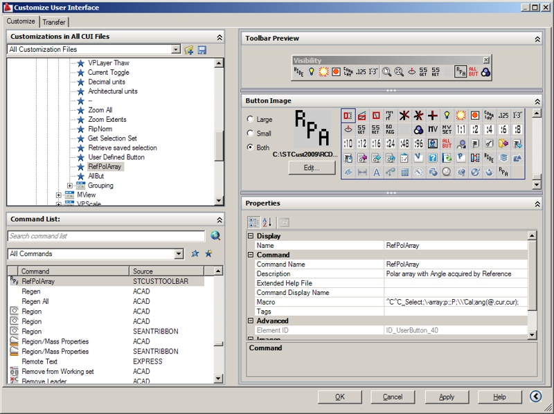

Thank you, Sean!
This appears to be exactly what I am looking for!
Unfortunately, I do not understand how to make it work. I tried pasting that code in the command line and nothing happened. Could you please explain how to use the macro?
P.S., That animation is awesome!
While it would be possible to automate this with Lisp or any of the other programming languages, the process was basic enough to just set up a command macro in a toolbar button. This is set up with the CUI command. See attached.
Fantabulous!
I finally got it working, I just had to create a new toolbar to get it to happen.
