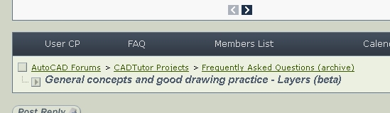

David and dbroada, you guys are both on the FAQ team which is probably why you can both follow the posted link with no problem and the rest of us cannot. Does the link go to a page in your archives or does it go to a page in the public FAQ section?
Here's the forum path that I see:
-David
That's the beta project area. Anything posted in there will not be available for viewing by anyone except FAQ team members.
