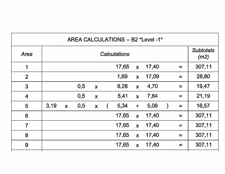

I have several long tables with fields for which I would like to automate data input so that I don't have to select the field type/ property/format each time.
Can anyone help me with a command/lisp routine that would "edit field" (a repeated field in a table) and change said field to an:
(1) object measurement data*
or (2) object area data*
only by having to select the object and bypassing the selection of the type, property, format, etc.
(*=maybe 2 distinct routines are actually necessary)
Alternatively, a simpler command/lisp routine would insert a field on the drawing with the above data (measurement/area), that I could then copy and paste into the table cell.
Many thanks!

Thanks, this seems to work except for the property "Measurement". How do I add it to the routine?
'Measurement'? As for dimensions?
Do you still need Perimeter?
I don't need the length/perimeter. The "area" field is related to a physical object which works well, but I need a "measurement" field when I pick the dimensions associated with the object.
My table basically consists of showing how the area is calculated so I need to input(link) the dimensions into the "equation side" of the table, and the area to the "total side".
I thought the area numbers had to be accurate but instead they have to match the calculation exactly (precision-sensible). To that regard, I have to actually let Autocad calculate the formula and only input the fields connected to the measurements. See attached table example.
I like how this routine works, can you help simplifying the routine by just asking for 'Measurement' property, in other words select dimension, place in table/cell?
ps. I've tried to change the routine myself but I keep on getting invalid object or error...

It's not really working. For some reason it's inserting the dimension value followed by "\ X".
Anyway, the input value is text and really needs to be a field, much like your earlier routine for the area, length fields.

Cool! This does work.
Is there a way to automate creating fields in a sense of remembering previous settings?
For example: I create field that is linked to an object, objects property, than I set precision and additional parameters.
Than I want to use all the same except for an other object....
update:
.... I'm a donkey...
Of course Lee Mac solved it long time ago writing Areas2AttributeV1-1.lsp that is easily modified to all of my needs.
Thanks Lee, once again.
