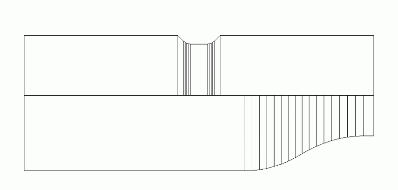

KRBeckman Posted February 8, 2010 Author Posted February 8, 2010 Here ya go... Most of what I will use this for is just the tops of office desks (I work for a large Office Furniture Manufacturer). So it'll all be 2-d polylines. PLINE EXAMPLE.dwgFetching info... Quote
David Bethel Posted February 8, 2010 Posted February 8, 2010 That is exactly what pol-fill.lsp can handle I do see a bug with pol-fill To fix it: _Convertpoly _Heavy Select your line (load "POL-FILL") Command: POL-FILL Select Y axis boundry Pick a point where both end lines are vertical Pick the LINE Border Do you have an editor that can change all of the faces edges to invisible ( change dxf group 70 to 15 ) I'll have to dig into it and find why it isn't converting LWPOLYLINEs into HEAVY POLYLINEs automatically. It should be doing it. -David Quote
