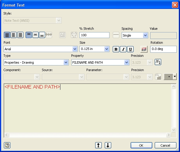

When printing an IDW, is there any way to get the file location of the IDW printed on the drawing?
Just add text to you drawing and select Properties-Drawing and then select filename and insert it. I have included a picture to help explain things.
