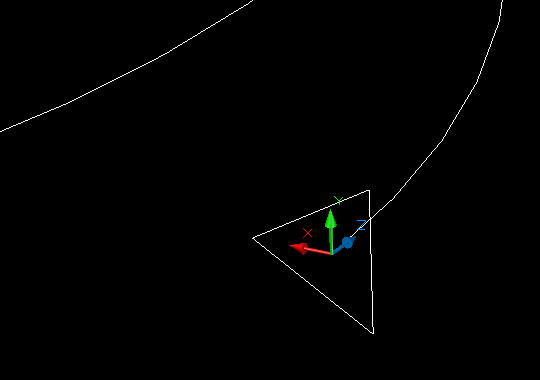

I try to always orient my USC perpendicular to my sweep path to make it easier to orient my sweep profile.

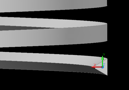

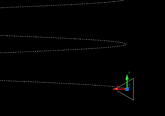

Align "will" put your profile perpendicular automatically , however, you will still most likely have to rotate it, which can be difficult if it's not on the correct plane to start. That's why I prefer to orient my USC instead. I always cut threads this way.
It can be a trial and error prospect to get it rotated correctly if your working with an unusual profile but you'll just have to play with the commands a little.
