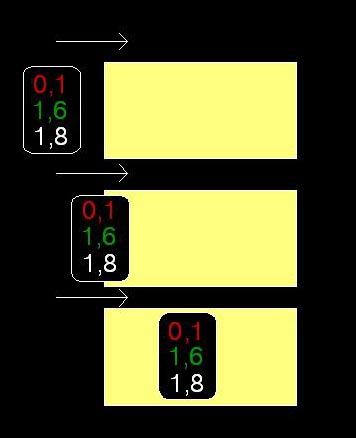

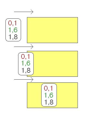

d3m Posted February 5, 2010 Share Posted February 5, 2010 How can I make "a hole" through hatch area? In model room it should look like this: Not like this: On paper it should look like this: Quote Link to comment Share on other sites More sharing options...
Tiger Posted February 5, 2010 Share Posted February 5, 2010 If you do the text first, and place it in the correct position and then do the hatch, the hatch will leave an area for the text. Quote Link to comment Share on other sites More sharing options...
d3m Posted February 5, 2010 Author Share Posted February 5, 2010 But what if I want to place my text on lines? How can I make circle or square that will print white and which I could write into? I'm looking for command like "wipeout", but with that I can't write my text. Quote Link to comment Share on other sites More sharing options...
Tiger Posted February 5, 2010 Share Posted February 5, 2010 use MTEXT, and enable Background Mask. Don't know if you can make it circular though. Quote Link to comment Share on other sites More sharing options...
Pablo Ferral Posted February 5, 2010 Share Posted February 5, 2010 If you don't want to use a hatch with island detection then Mtext Back ground mask, Wipeout or a solid hatch are your options. Quote Link to comment Share on other sites More sharing options...
