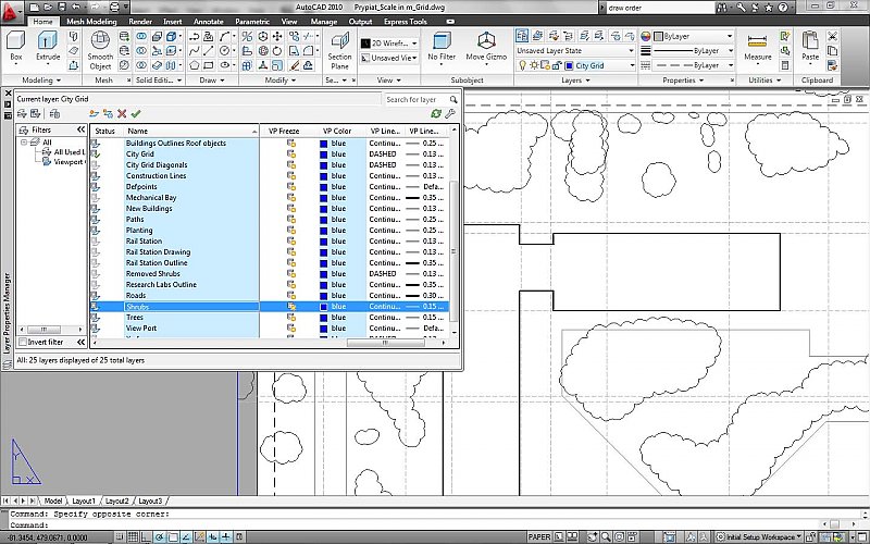

Hi,
I'v got an autoCAD drawing I'm trying to quickly print so I can overlay but I don't have any black ink Haha. So I'm trying to change the colours of all the lines in the drawing to blue in one go using the VP Colour option in the layers manager. However, it doesn't seem to have any affect? Is there a command I need to type or something so the VP colour works?
Have you set Blue to plot as Blue in your .CTB file? or set the plotstyle to 'Colour' if your using named plot styles?
Try to check your Plot Style or your printer settings.And what do you mean by "it doesn't seem to have any affect"?
you have the viewport in question active right?
