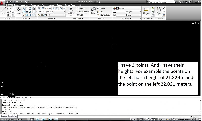

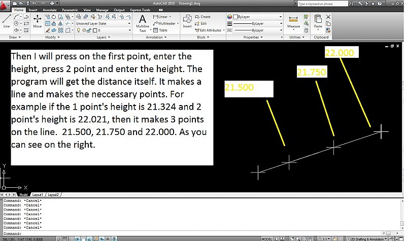

This lisp is amazing, but can anyone help me. I need to interpolate with 0.25 height difference. For example 21.25 21.50 21.75 22.00 .
I have been looking at this code for an hour now and I don't get it.
I could really use your help because I need to create a topographic map and I have to interpolate over 300 points.
Are you referring to my code Ogre?
Sry for not specifying, I was up late. I am doing the interpolation in a 2D environment so I could really use the first code.
But if you could help me, then I would really appreciate it.
many months ago Ihave written 2 programs by request of one of my correspondents back,
but she has not sent me the feedback and I do not know till now how these programs work
with practical drawings
Anyway you can try them just change text height to suit

Thanks for helping, I made some screenshots.
I tried the edited code using your z values and I get the same error.
In a nutshell, your code is trying to place a point at elevation 21.25 (not an elevation between the 2 given elevations)
this line
d1 (/ (- el1a el1) slp)
is returning a negative number. This causes the vlax-curve-getPointatDist to return nil- hence the error.
this line
Thanks, I now understand the problem. Is there a way to fix it?
