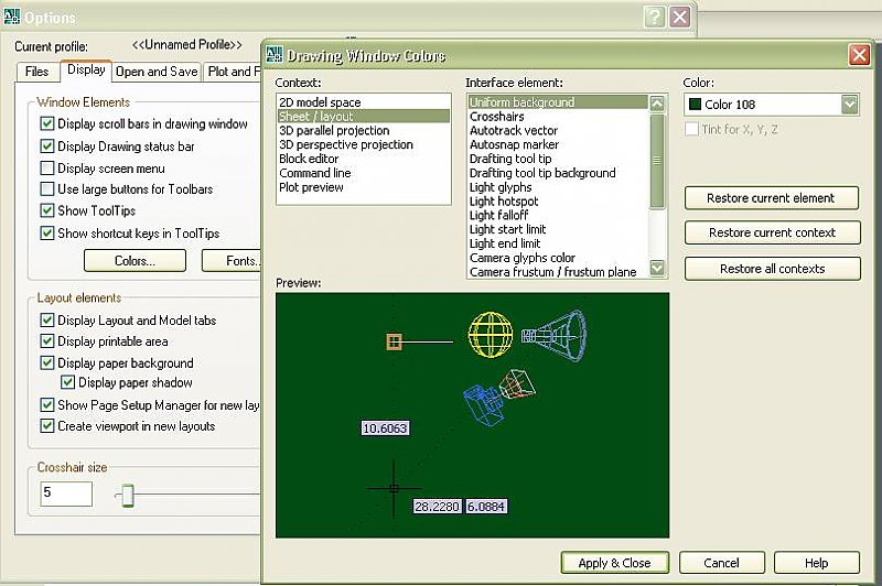

You can change model space or layout with any color you want, just change the color display setting. See this picture!
Thank you for the reply,
But I have changed these settings but the lines on the paper space are still colored when I would like it to be just black.

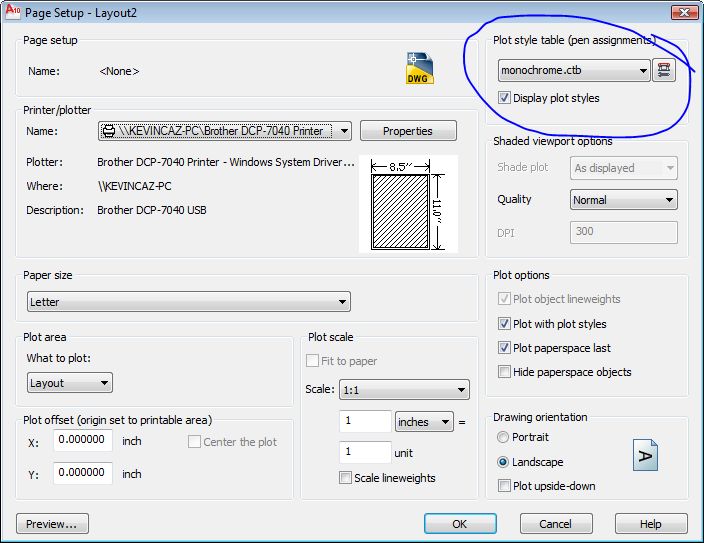

Try entering "Page Setup" and check "Display Plot Styles" and see if that works...
