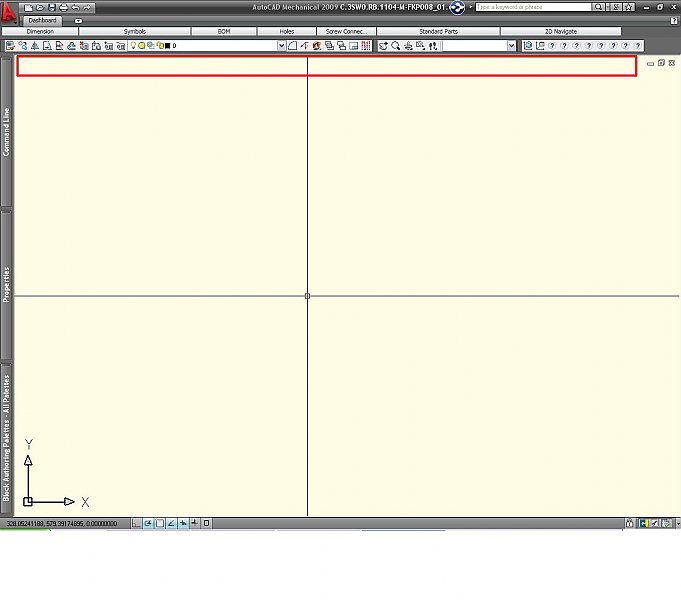

Just have a quick query as to how I might toggle my block toolbar which historically automatically loaded when I opened up the block editor? It's not there any more and I have no idea what it might be called in the CUI?
I have the same problem when the Ribbon is open. There is a Ribbon Panel (Tab?) that will display the toolbar stuff when you open the Block Editor. Try opening the Ribbon so you can see it or close the Ribbon before you open the Block Editor.

Hi lpseifert, just reporting back that for whatever reason by removing the dashboard the toolbar reappears... so it's linked to the ribbon, but now I'm wondering if there's a way to install the toolbar onto the dashboard?

I thought that 2009 got rid of the Dashboard and replaced it with the Ribbon. Like I mentioned, when I open Block Editor (when I have the Ribbon open) the Ribbon's panel switches to the Block Editor (including the tools for Block Editor). It came like this OOTB. It annoyed me so I pieced together this code that closes the Ribbon before opening the Block Editor so the tools display in the Block Editor. I don't know if it will work for you if you don't have the Ribbon.
(defun c:bed ()
 (vl-load-com)
   (setq bn (vla-get-effectivename (vlax-ename->vla-object (car (entsel "\nPick block to edit: "))))
   rs (getvar "ribbonstate")
 (if (= 1 (getvar "ribbonstate"))
   (vl-cmdf "ribbonclose")
 (vl-cmdf "bedit" bn)
 (if (= 1 rs)
 (vl-cmdf "ribbon")
I thought that 2009 got rid of the Dashboard and replaced it with the Ribbon...
Yeah for all versions but Mechanical, don't know why, but this is the only vertical product that retained the dashboard in 2009.
