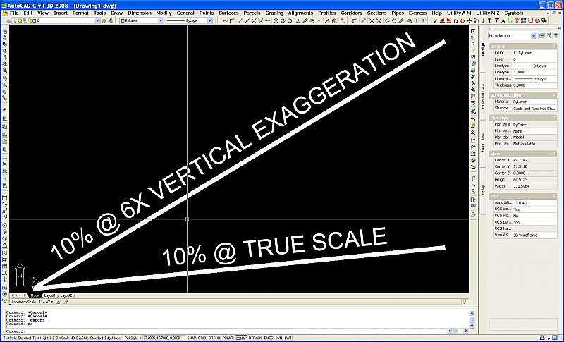

lpseifert Posted February 2, 2010 Posted February 2, 2010 Try drawing it at true scale, make a block, insert the block at an x scale of 1 and a y scale of 6. Quote

lpseifert Posted February 2, 2010 Posted February 2, 2010 JD Mather said: I'm not in the civil field, not sure I follow. Is this two scales on the same drawing or is this a scale for portrait orientation of the sheet and a scale for the landscape oreintation of the sheet? Maybe this will help illustrate what vertical exaggeration is. Quote

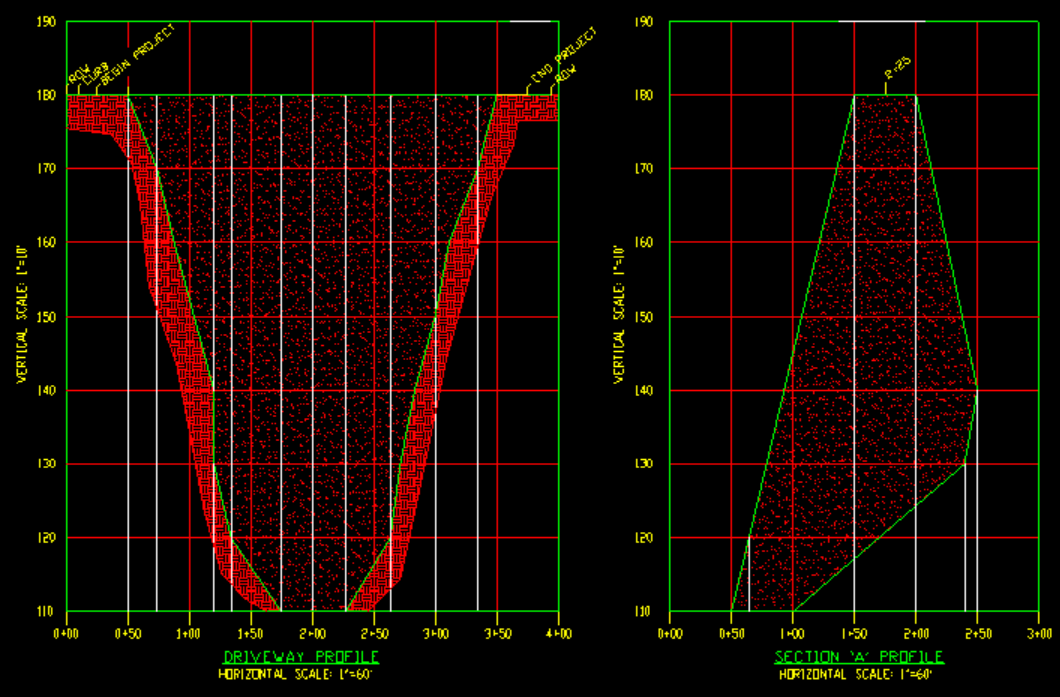

banyameen Posted November 28, 2024 Posted November 28, 2024 what that means For the driveway profile, use a vertical scale of 1″ = 10′ and a horizontal scale of 1″ = 60′. Show the stationing, however, in 50-foot increments. Therefore, when plotting the drawing, the distance between Station 0 + 00 and Station 0 + 50 will be 5⁄6 of an inch. Quote
ReMark Posted November 30, 2024 Posted November 30, 2024 (edited) It means just what it says. Every inch vertically will be the equivalent of 10 feet while every inch horizontally will be the equivalent of 60 feet. Since stationing is along the horizontal axis (and runs left to right) 0+50 would fall 5/6ths of an inch to the right of 0+00. See example driveway profile and section below. Edited November 30, 2024 by ReMark Quote
