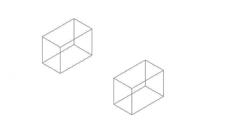

ReMark Posted February 2, 2010 Posted February 2, 2010 Two boxes. They are the same size. The one on the left was drawn using the line command. The UCS was reoriented to draw the vertical lines at the corner. The one on the right was drawn normally and extruded vertically. They are shown in typical 2D wireframe view. Quote

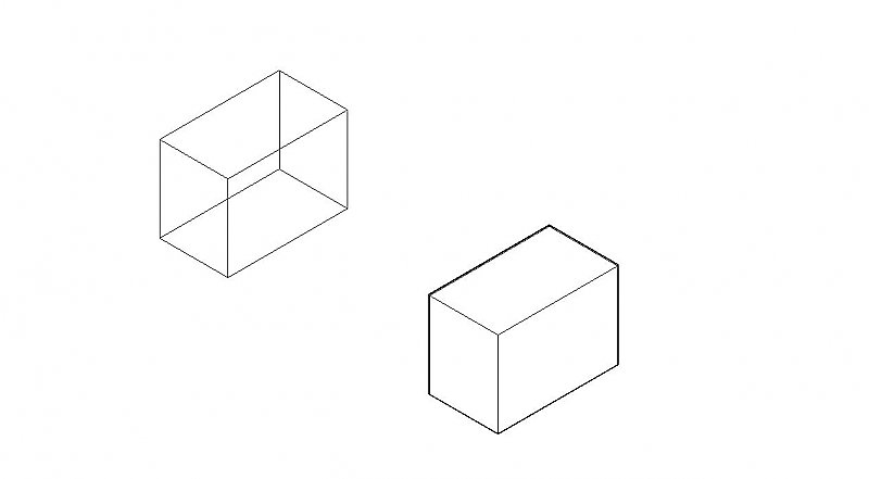

ReMark Posted February 2, 2010 Posted February 2, 2010 The same two boxes as shown above however we have elected to show them in 3D Hidden view. Which box would you rather show to your client or boss when he asks to see that nice 3D drawing you just did? Quote
rah32d Posted February 2, 2010 Author Posted February 2, 2010 Yes, the second one where you can switch from wire frame to hidden is what I've seen from the detailers before. Quote
rah32d Posted February 2, 2010 Author Posted February 2, 2010 The second set up you illustrated would be perfect what what I was attempting. Do you happen to know of any turorials on how to set up a drawing like that? Quote
ReMark Posted February 2, 2010 Posted February 2, 2010 Yes, the second one where you can switch from wire frame to hidden is what I've seen from the detailers before. Then you do NOT want to independently draw all lines (both horizontal and vertical) as that would defeat your purpose and make for a poor excuse for a 3D drawing. That's just drawing stick figures. Quote
