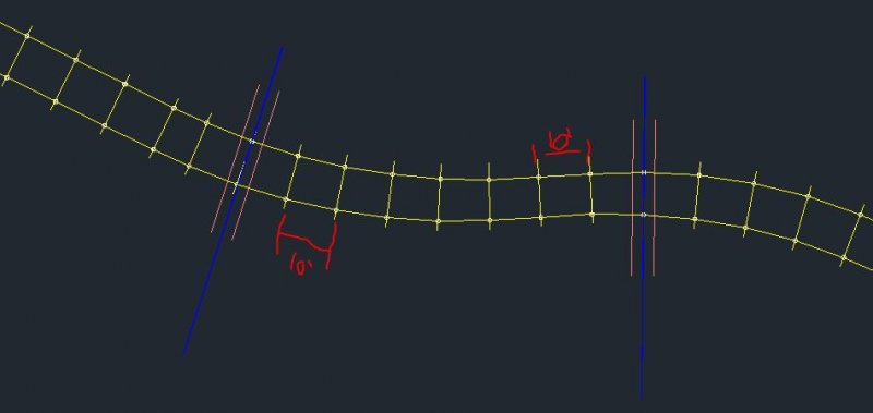

Lee Mac,
With the LISP you have posted here, can it be modified to take a POLYLINE and segment it at a certain distance?
i.e. - I have a curving boardwalk that I need to segment every 10' on the outside curves, is that something that can be done?

I know about he divide command, but that just breaks an object into equal segments, I want to take an about object (i.e. 138'-9'' arc or POLYLINE length) and break it into as many 10'-0'' as I can. Does that make sense?

Well, if you're looking for the routine, one of our Experts could help, but if you just need to solve this issue for now, obviously you can use the divide command and I guess you don´t need to know how to use it for this case, or do you?
Please tell me that you know how to get 10' equal segments using the divide command
I was actually able to achieve the same results using the MEASURE command.

First off, I just discovered LISPs this afternoon (after using AutoCad for over 15 years), the code you provided Mr. Mac works almost perfectly for what I am looking for, but it flattens my contours/polylines so they are all on the same Z elevation. Is there any small tweak to make it not do that? I know this is an old thread, so I hope you still monitor it. As a couple other people have mentioned, I need to take a bunch of polylines and segment each one out so they are made up of similar length segments (e.g., 10').
Thanks!
Matt
Perhaps something like this? Might need a bit of refining for closed entities:
