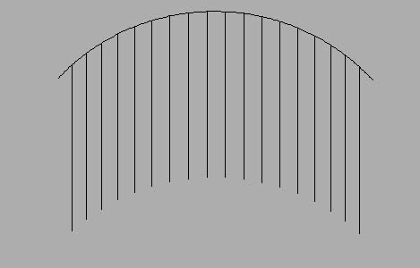

louislaw Posted January 28, 2010 Posted January 28, 2010 hi all! i m looking for an easy and efficient way to indicate a curved wall on an elevation drawing. what i m doing now is to draw a single line first, and offset the line by 10mm and then repeating the offset action with the newer line by 10mm more than the previous. it is absolutely time wasting! any easy and efficient way to do it? thx! something like this: |_|__|___|____|_____|______| Quote

CarlB Posted January 29, 2010 Posted January 29, 2010 Those lines represent even angular spacing. You could do a polar array to follow the circular portion in the plan detail, say 5 degree increments, creating "spokes". Then draw vertical lines from spoke endpoints through the elevation detail. using copy multiple, endpoint snaps, trim, should go pretty quick. Quote

eldon Posted January 29, 2010 Posted January 29, 2010 If you make a block which is a vertical line, then using Measure or Divide with a block, but do not align block with object, then a quick explode, extend and trim, you might have the geometrical solution. But it actually does not look so good with shallow arcs, and you would be better doing what you already do. Quote
dbroada Posted January 29, 2010 Posted January 29, 2010 or having done it once create a dynamic block that can be stretched into place. Quote

Noahma Posted January 29, 2010 Posted January 29, 2010 Geobuilder said: Or as a variant the command divide, will mark a curve on the necessary number of segments with the set step this is exactly what I do. Works great, and does not take much time. Quote
lpseifert Posted January 29, 2010 Posted January 29, 2010 (assuming you're in World UCS) Rotate your ucs around the x axis 90, use Plan > Current. Draw the 'wall' in plan as you did in post #3. Divide it with the number of segments you want (points). Go back to World > Plan. Use the nod osnap to draw the vertical lines from the points you just created using the Divide command. Probably not real fast, but accurate. Quote
