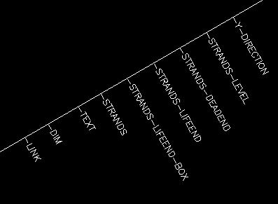

I've searched the internet for a LISP routine that will grab lines of individual text and re-list them correctly aligned and equally spaced apart.
Anyone know of a LISP that does this or something similar that I can edit?

Found something:

Thanks ASMI but I cut and paste the code into a notepad file with result of .....
Command: _appload
"no function definition at [EVAL]"
.. when I tried to load application. Any ideas?
Command: _appload
It strange message, I really don't know. Get working *.lsp file.
DALY.lsp
I have now found out from one of our IT guys how to make it load by downloading the acad simulation from LT Extender.
If anyone wants to know more details then I can get more details how he sorted it.
