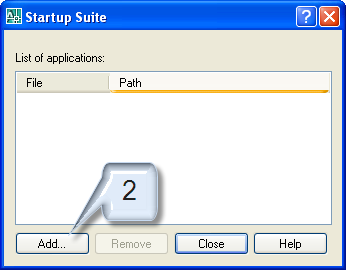

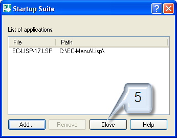

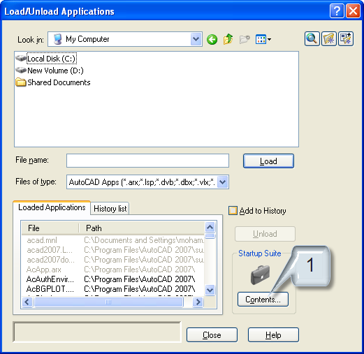

asos2000 Posted January 18, 2010 Posted January 18, 2010 In command line type APPLOAD then follow the attached Quote

LEsq Posted January 22, 2010 Posted January 22, 2010 Rule 1 = Avoid the startup suite, period. What are the side effects? I use nowadays a single lisp file - that I loaded that way, with a few routines that use on a daily basis... Quote
LEsq Posted January 22, 2010 Posted January 22, 2010 I have the lisp routine in my briefcase already. The problem is that to invoke the comand reactors I have to type >REAON once the drawing is open. I want it so I dont have to do this and the command reactors are always on. Lee - I tried putting the command line in the acad2010doc.lsp but it didnt work? Here is where i put it . . . ;;;===== AutoLoad LISP Applications ===== ; Set help for those apps with a command line interface (setfunhelp "c:gotourl" "" "gotourl") (autoload "edge" '("edge")) (setfunhelp "C:edge" "" "edge") (autoload "reaon" '("reaon")) (setfunhelp "C:reaon" "" "reaon") (autoload "3d" '("3d" "3d" "ai_box" "ai_pyramid" "ai_wedge" "ai_dome" "ai_mesh" "ai_sphere" "ai_cone" "ai_torus" "ai_dish") Is this right? If this is for reactors... there is a way to auto load the routine automatically and only to the drawing that have the reactors used... Now, I need to do a search here on my pc, to know where I left that code... it was a single code line - no need to any known means of autoloading a lisp routine btw. If I found it, will post it here. Quote
rkmcswain Posted January 22, 2010 Posted January 22, 2010 What are the side effects? No way to automate the list of files. No way to migrate this list from machine to machine, from version to version, or even from windows profile to windows profile. No way to populate this list on multiple machines No way to manage this list on multiple machines etc. etc. (Ok, technically, if you are proficient with the windows registry and registry scripts, you could do these things, but who wants to when there is a much easier way..?) I guess if you are a solo operator, with a single install, and had zero experience with autolisp, then I could understand.. but it's not like creating a text file with load statements (the "acaddoc.lsp" file) is rocket science. Quote
