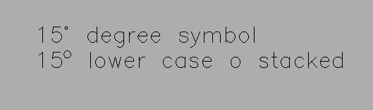

How do I go about increasing the diameter to a degree symbol? Am using the ROMANS.SHX type of file, and when used the degree symbol is sort of miniature (looking and plotting) in comparision to the numeral next to it.
What number do I have to alter in the .SHX file to enlarge it then?

At the risk of being told that I can't read again, I would suggest that if you are using Mtext, you could stack a lower case "o"
Eldon... That has been my work-around for some time now.
But, am using DTEXT at present time.
Was told there was a way to alter the original .SHX or SHP file and get an increase in the O size.

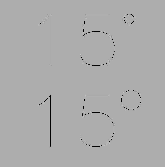

When you find your Romans.SHP file by searching on the web, you then can open the file, find the degree symbol, and change the digit immediately after the 10 digit, to a figure twice as much. Then compile it, and remember what the shape number was, and this is what it looks like (second line of text). Good for bifocals :D

You have to search on the web, as I said, for the SHP file. The SHX files are compiled and you can only read them if you are a computer. I don't think that AutoCAD supply SHP files.
The digit after the 10, I changed from 2 to 4 on line 127. You compile it by typing COMPILE on the command line. So it is really a small job.

After a bit of further delving, you actually have everything that you need already.
In Express Tools (which we have established that you have access too), there is an OS command line programme called DUMPSHX. This converts existing SHX (compiled) files to the equivalent SHP (decompiled) files.

It needs to be run from the DOS prompt (Windows Start > Run > cmd) with the appropriate switches; the method is described in Express Tools' help.
