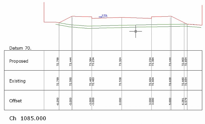

We used to have a routine in VB for indicating the slope of a line in % terms. The guy who wrote it has left the office and I know even less about VB compared to lisp. I was wondering if someone could write a lisp to produce the arrow ad text as shown in the attached file based on the current textstyle and dimstyle?
Thanks.

Thanks, this has the basics of what i need but can it be put in the format as per my image at the start of the post??

Try this one
Text height will the same as for the current dimension style text height

That's exactly what i was looking for Fixo. Thanks
