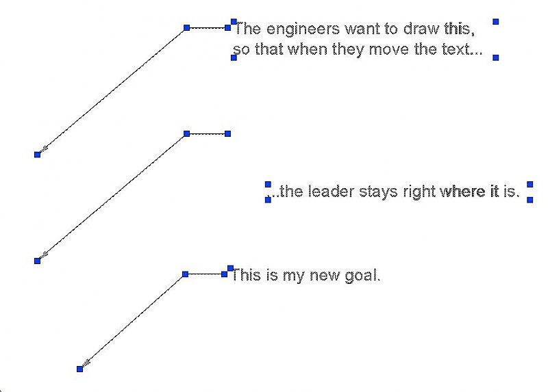

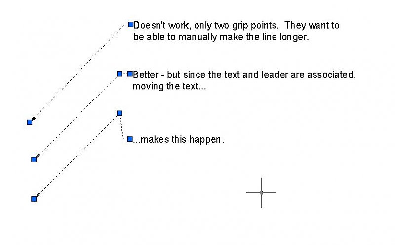

SpeakNoEvil Posted January 14, 2010 Posted January 14, 2010 Hello all, I'm working on CAD sheet set templates for other engineers in my company, and I've hit a snag. All the engineers I talk to want the following out of their Leaders: 1. Needs three grip points, at the arrow, kink, and text end. They want to be able to manually make the horizontal line next to the text longer. 2. Should NOT be associated with the text - i.e., when you move the text, the end of the leader doesn't move with it. I've attached an image that shows why they don't like the association. Our office uses a mix of AutoCAD 2007, 2009, and 2010, and I'm on 2007. Any suggestions on how to break that connection so the leader stays put when the text moves? Aside from manually drawing every leader and MText separately? The template has hundreds of leaders, so quicker methods are better... And if there's a way to do it similar to MATCHPROP to all the existing leaders in a sheet set, I'll bow down before you. Thanks! Tom P.S. I've tried to encourage different leader methods, but this is what the engineers prefer, so any arguments that they should do it differently, while possibly true, probably aren't very helpful. Quote

CadiCad Posted January 14, 2010 Posted January 14, 2010 Using the dimension leader independent of the text will allow you to click three points without attaching the text to it. Select Dimleader command. Select your three points, when It tells you to insert text press escape. Leaving the dimension leader without entering text, Then create a MLtext. Hope this helps -CadiCad Quote

BearDyugin Posted January 15, 2010 Posted January 15, 2010 SpeakNoEvil, Try this macro ^C^C_leader;\\;;_non;_mtext;(getvar "lastpoint");(getvar "lastpoint"); Quote

SuperCAD Posted January 16, 2010 Posted January 16, 2010 Can you post a picture of what their desired result is? Show us what they "want" to do. Quote
BearDyugin Posted January 18, 2010 Posted January 18, 2010 SuperCAD said: Can you post a picture of what their desired result is? Show us what they "want" to do. Or you have not understood me, or I cannot understand you... In the previous message I have given the reference to video (the animated image in a format gif), I did not begin to place it am direct here in the message since it of big size (6299 кб), after all for certain is users with slow speed of connection or expensive traffic. And so in that video it is in detail shown as to use a macro, on an example of particularly mine, in the end it is shown as will be the new command works. I duplicate once again only as it will work: Quote

SpeakNoEvil Posted January 18, 2010 Author Posted January 18, 2010 Geobuilder: the macro is good, but it seems to lack some of the advantages of the original leader; making a right-pointing leader, for example, becomes a little messy. This seems like an excellent route to take, though, and I may try making one myself using nukecad's initial EXPLODE-TXT2MTXT suggestion. SuperCAD: See the drawing attached. nukecad & Stix: I agree with both of you. There are a lot of ways the engineers could do a better job of this, and to be honest the more I talk on this forum the more I agree that what they want doesn't really make sense. Creating it that way would merely add to more problems later, as Stix points out. Once the office has all moved to AutoCAD 2009, everyone will use Mleaders anyway. I'm thinking now I may abandon the idea of moving the text independent of the leader. I'll still do the three-grip leader, so the engineers can change the horizontal line length. Then my only concern will be making sure I draw them all the same length initially. Stix: is there any advantage in turning off the little automatic horizontal bit in this case? Thanks a lot for your help! Quote
