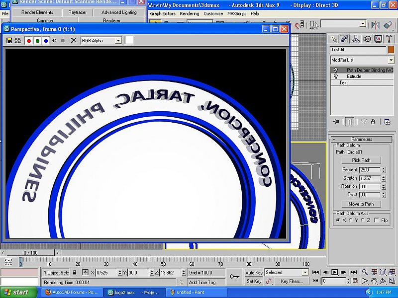

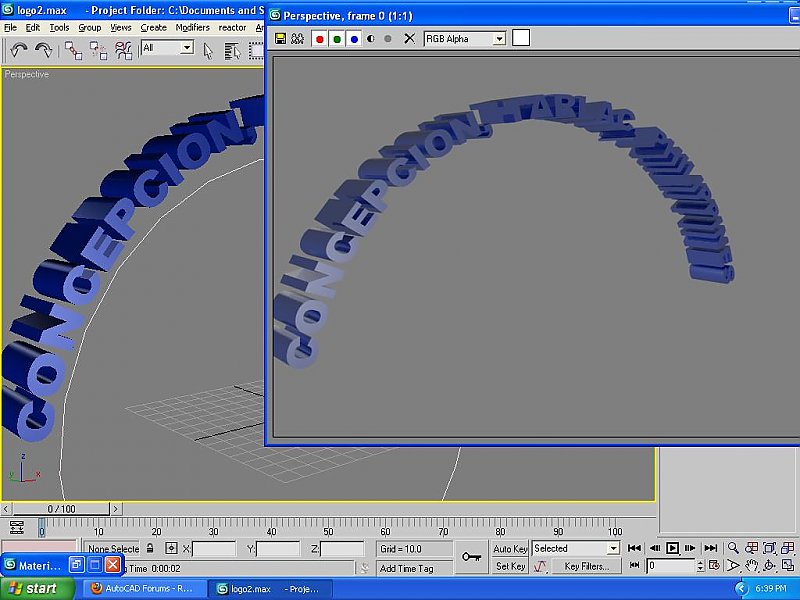

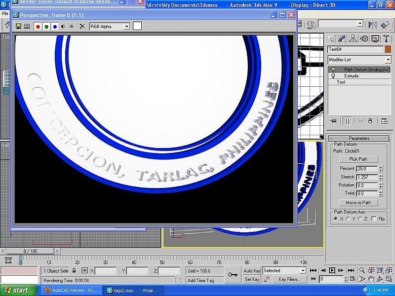

valrecx Posted January 16, 2010 Author Posted January 16, 2010 Hello again, When i place the text that i modified with path deform, at the bottom of a circle path, looks like there is no cap on the holes thats why it render like the one on the picture, but when i place it at the top, i got the image that i want to see. What might be the problem? Quote
Cad64 Posted January 16, 2010 Posted January 16, 2010 It's hard to tell from looking at the images. Is the text being flipped inside out? The top image shows the text reading backwards but the bottom image reads correctly. Check your surface normals. You may need to flip them. Quote
valrecx Posted January 17, 2010 Author Posted January 17, 2010 Path deform needs a object path like a circle or curve so that the text will follow this path right? I use a circle to act as a path, when i place the text above this circle the rendered image is good but when i place the text at the bottom of the circle path and rendered it, It shows a rendered image like in the 2nd image above, even if I flip it. Quote

Cad64 Posted January 17, 2010 Posted January 17, 2010 Yes, it's exactly as I said. Your surface normals are flipped. 1. Select the text and convert it to editable poly. 2. Switch to Polygon selection mode and window select all the text so that it all turns red. 3. Click the "Flip" button, (It's under the "Edit Polygons" rollout menu). Now render again and I think you will get the result you're looking for. Quote
