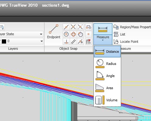

Here's where I found it in TruVeiw 2010. -David

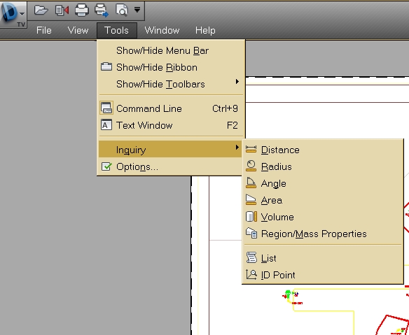

I downloaded DWG TV 2010 and although it seems a little different to David Bethels's version I have found the angle option.
Can anyone give a quick pointer on how to use it?

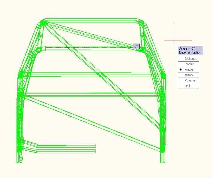

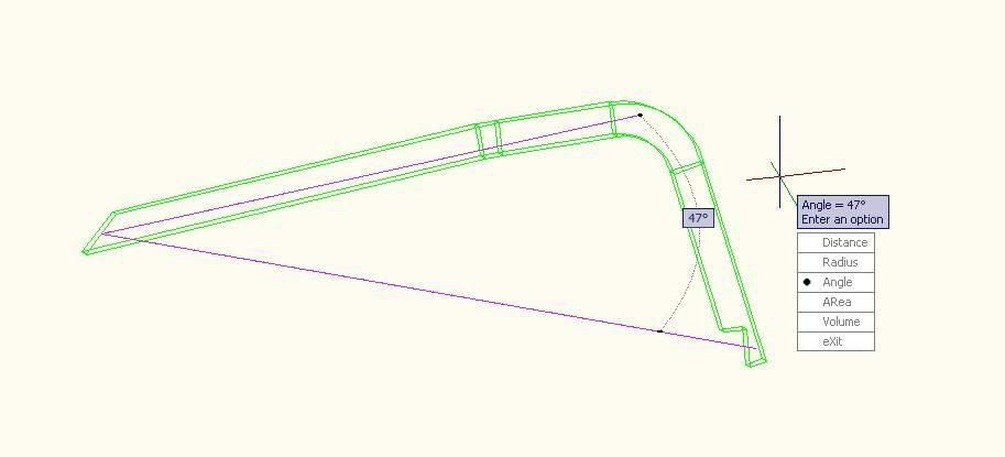

Here's a couple screenshots of my attempts:
untitled.jpg?t=1263476816
As can be seen, I plot the first point to the far left and the second to the far right, I then moved the arc to the centre of the bend (or there abouts) the angle it says seems about right I would say. Is this the correct way to go on?
untitled-1.jpg?t=1263477769
As can be seen here I have drawn a straight line and not moved the arc so it says there are zero degrees between the two points. As I expected/hoped for. I understand this, just unsure on how to work out angles, such as the 45* ish bend above.
Thanks for the help. Hope I'm not being too stupid!

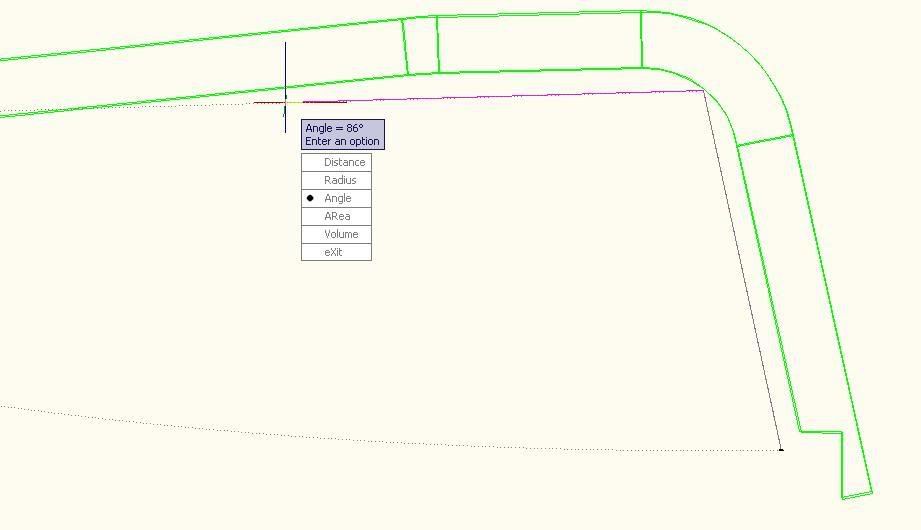

I assume this is the way to go on?
untitled-3.jpg?t=1263494766
I appreciate it is not very accurate which is why I'd lke to do it the way you describe, to snap onto certain parts of the image.
Where would I find this part of the program? Maybe this should be in the newbie section, but again there doesn't seem to be much there for people like me who don't want to design from scratch.

Try invoking the Distance command first then if prompted for a start point pick the center of the one end of the tube. For the second point pick the center of the other end of the tube.
