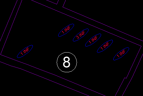

Thanks for your attention. The center of the polygon is the ideal place. You can express the result circled in red with the "existing gain" layer.
I currently use these two routines that I found on these forums, but I would like to speed up the process.

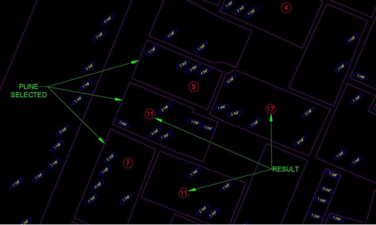

Dear Bigal. Thank you for your help. It works excellent, but the labels to add have variable amounts. You can modify the routine, to add the numeric text quantities.
I apologize for not being assertive in my request.
Ok its time for you to have a go at lisp, dont worry if get wrong just post here and we can help.
(setq ss2 (ssget "WP" co-ord '((0 . "ELLIPSE")))) change to TEXT
(setq cnt (sslength ss2))
becomes a loop
(setq cnt 0.0)
(repeat (setq x (sslength ss2))
get each item in selection set
then get text value
add text value to cnt
If you look at code you can see a repeat example.
Ps tested already is adding values but have a go 1st.

Bigal saludos cordiales desde México. Siento decir que no sé nada de programación. No sabría arreglar la rutina para que me diera el resultado esperado.

Try this it is based on "X INFO"

(setq ss (ssget '((0 . "LWPOLYLINE")(8 . "MANZANAS")(70 . 1))))
(command "zoom" "e")
(if (= ss nil)
(progn (alert "No objects found on layer MANZANAS ")(exit))
(repeat (setq x (sslength ss))
  (setq plent (ssname ss (setq x (1- x))))
  (setq co-ord (mapcar 'cdr (vl-remove-if-not '(lambda (x) (= (car x) 10)) (entget plent))))
  (setq cpt (mapcar '(lambda ( x ) (/ x (length co-ord))) (apply 'mapcar (cons '+ co-ord))))
  (setq co-ord (cons (last co-ord) co-ord))
  (setq ss2 (ssget "WP" co-ord '((0 . "TEXT"))))
  (if (= ss2 nil)
   (princ "miss")
   (setq cnt 0.0)
   (repeat (setq y (sslength ss2))
   (setq ent (ssname ss2 (setq y (1- y))))
   (setq val (atoi (cdr (assoc 1 (entget ent)))))
   (setq cnt (+ cnt val))
   (command "-insert" "countbub" "s" 1 cpt 0 (rtos cnt 2 0))
(setvar 'osmode oldsnap)
(c:startshere)

  (if (= ss2 nil)
   (princ "miss")
   (setq cnt 0.0)
(c:startshere)
Bigal thank  very much. I really appreciate your help. works excellent
