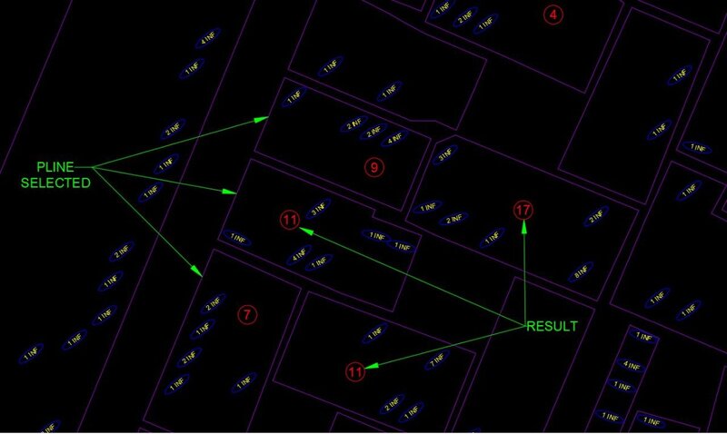

Working great (but not on solid hatch)- any ideas why?
Gile's code- excellent but is matching layer of first selected object and other properties (suffix, precision) from object selected as a last :?
Sorry for making so many problems
and I've found another BIG issue wit gile's code. You need to select each label individually rather than all of them on one go- you can imagine what will happen if you have 2000 labels with areas!!!!! Any solution?
Seems to work ok for me... :unsure:
I don't particularly want to mess with Gile's code too much, as I'd rather let him modify his own routine. :wink: but I can see what I can do

Apologies for messing with your code Gile.
sounds good to me :twisted:
I'm using Civil 3d 2010 at home and is not working with solid hatch!
I'll try at work tomorrow morning with CAD 2009, 2010 and Civil 2009, 2010- will see is there any difference.
Have a nice evening!
No need to apologize, Lee, I had no time to do it...
When you say it is not working - what happens?? Does it throw an error? Does the field show ####?
SORTED GUYS!!!
I've change some settings with selecting objects and is working GREAT!
THANK YOU VERY MUCH!!! :shock:
SORTED GUYS!!!
Does the Hatch now work? Are you referring to the code I modified above? :unsure:
solid hatch is working now :shock: (I've change my civil 3d settings)
once again thank you very much
Excellent :)
