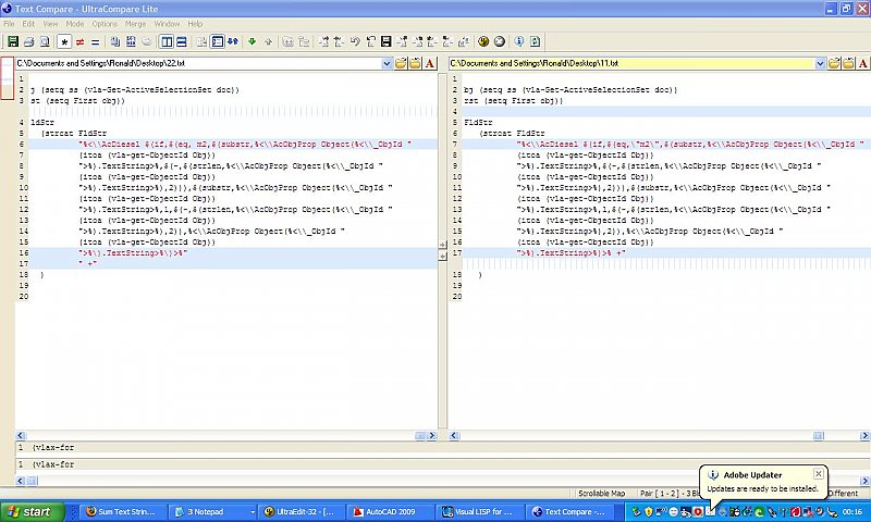

I think I know where is a problem. First routine (fArea.vlx) creates labels with field and text 'm2' or whatever user will type. And this 'm2' is not a suffix- is a text. So if somebody can create routine which will do the same (measure area of selected object) with proper suffix (maybe asking user to define one)- then the last code from gile will work perfectly, reading precission, format, suffix). I need to start looking for some lsp tutorials... you guys are doing magic!
Haha not a chance mate... :geek:
On a side note... Wiz, could you collaborate to see if we can get this working? (just for academia)
(vlax-for obj (setq ss (vla-Get-ActiveSelectionSet doc))
       (or First (setq First obj))
       (setq FldStr
        (strcat FldStr
          "%<\\AcDiesel $(if,$(eq, m2,$(substr,%<\\AcObjProp Object(%<\\_ObjId "  (itoa (vla-get-ObjectId Obj))
                ">%).TextString>%,$(-,$(strlen,%<\\AcObjProp Object(%<\\_ObjId "  (itoa (vla-get-ObjectId Obj))
              ">%).TextString>%),2))),$(substr,%<\\AcObjProp Object(%<\\_ObjId "  (itoa (vla-get-ObjectId Obj))
              ">%).TextString>%,1,$(-,$(strlen,%<\\AcObjProp Object(%<\\_ObjId "  (itoa (vla-get-ObjectId Obj))
                        ">%).TextString>%),2)),%<\\AcObjProp Object(%<\\_ObjId "  (itoa (vla-get-ObjectId Obj))
                ">%\).TextString>%\)>%" " +")))
working but will not be updating the new total area when changed because of the if statement inside diesel.
Am I right in saying that you only changed the quotation marks in m2? :)
i think last line also lee, be back tomorrow..'-)

and find the way of asking for conversion factor (in your code)
What do you mean by this? :unsure:
I meant another option to ask user for conversion factor as you asking for text height, rotation, angle, units type, precision...
ie. dwg is in meters but they want labels in ha, so changing suffix is simple (now :)) but if you will set the conversion factor to 0.0001, then label will return area in hectares.
If you will insert field, fields category: objects, select object, area, format, precision, than there is that extra button: Additional Format:
and you can set the conversion factor there...
