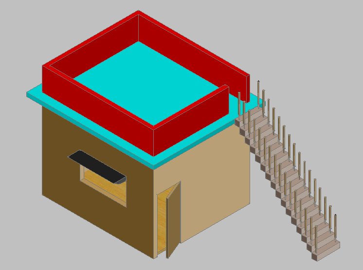

humaironline Posted January 12, 2010 Posted January 12, 2010 I want to repeat the stair railings by using 3d Array or any other command. Kindly help me out to do it. stair = L3' x W8" x h8" waiting a quick response.... Quote
amit87 Posted January 12, 2010 Posted January 12, 2010 I would be interested to know how this works too! Quote
stevsmith Posted January 12, 2010 Posted January 12, 2010 Why don't you just copy the objects, select both stantion posts, and use the toe of the step as your base point. It would probably take more time and to much effort to set up an array, besides this I don't think array can be used to go up at an inclined angle. Quote
humaironline Posted January 12, 2010 Author Posted January 12, 2010 its ok stevsmith...but i want to learn the 3d array ....by this problem. I hope any one will help me soon to solve this issue. so waiting.... Quote
iskalipsi Posted January 12, 2010 Posted January 12, 2010 I agree with what steve said.Copy would be easier. Quote
humaironline Posted January 12, 2010 Author Posted January 12, 2010 I tried but its not easier, to place on face. cross hair not select face easily..so I need to place a line on every step. so its better we solve it by array or other useful command. Quote

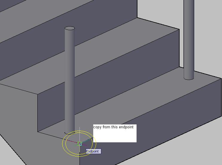

stevsmith Posted January 12, 2010 Posted January 12, 2010 try this, copy from the corner point of the tread and not the face Quote
humaironline Posted January 12, 2010 Author Posted January 12, 2010 ya....nice...thanks....every one...i have done it by using 2d array.... stevsmith...your last trick is also very good... now the problem is to draw a continues hand railing...that run on top of every pole.... can any one help to draw spline on them...i tried but it not look good. Quote

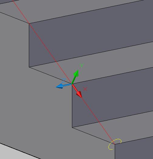

stevsmith Posted January 12, 2010 Posted January 12, 2010 you have to orientate the ucs icon to go with the angle of the stair, this will allow you to draw a handrail and extrude it along it's path. please note that this is only a quick example. I'm at work and don't have the time for a full on tutorial. but it is best to explore ucs manipualtion. It can be a pain at 1st, but it's worth it Quote

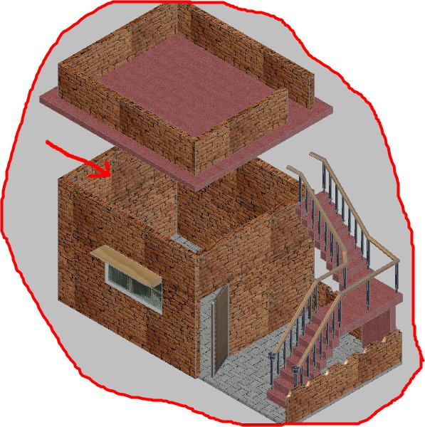

humaironline Posted January 21, 2010 Author Posted January 21, 2010 I want to apply material on inside wall, but when I apply it spread on whole wall. Pls tell me any way to apply separately. see the attachment. humair. Quote
iskalipsi Posted January 23, 2010 Posted January 23, 2010 i would create a thin wall for the other material.. Quote
melox Posted January 24, 2010 Posted January 24, 2010 You could open your Materials pallette, click on the material you want to apply whilst holding the control key and drag it to the face you want to Render. Hopefully that helps you my friend. Quote
humaironline Posted January 25, 2010 Author Posted January 25, 2010 Yah...thats was a good idea...thanks melox... iskalipsi...see the advice of melox... thanks....again...now i got ...it.. Quote
