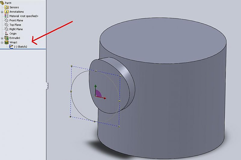

im using 09 currently but it doesnt create a plane or any other geometry with the wrap feature. If you Click Wrap without having a sketch it will go into sketch mode. This however will not let you select a curved face but only a planar one.

Well yes that works if you select a planar edge(top or bottom of my cylinder). In my screen shot i used the front plane to draw my wrap boss prior to selecting the Wrap feature.

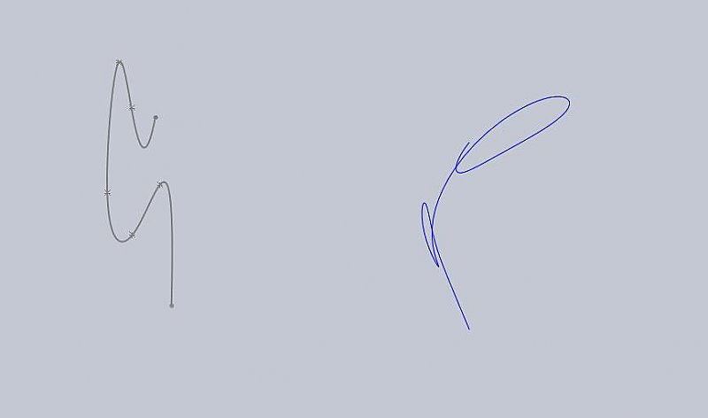

In this screen shot i have drawing a spline in 2d and projected it onto a 3d surface. I believe this is what he wanted to have a sketch on a curved surface. This is helpful when triming surfaces, creating 3d paths for sweeps or lofts and so on. The only thing i know you can draw on a surface/face is a spline though. The rest i believe have to be projected.
