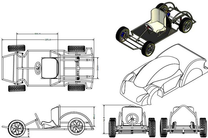

Improve Chassis design;any idea or comment
Hi,

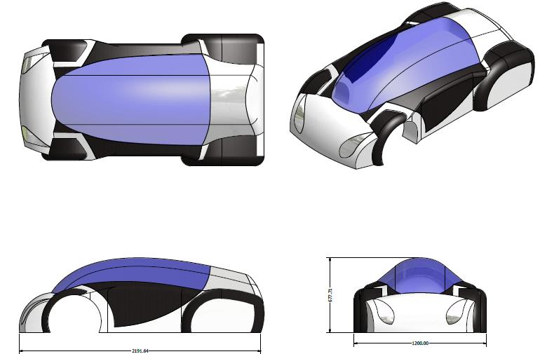

It has been some time since my last post.I'm still working on my project which need me to design a simple prototype car with its chassis.I've go through some of the tutorials and advices suggested to me from this forum. thanks for all;).here I attach some of my work and I need your comments on how can I improve it especially on the chassis..
I would put in some tangent arcs for the bends and sweep or use the Frame Generator.
