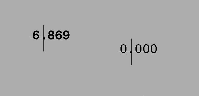

When I load lees program the text for the elevation just reads 0.00 what is causing this to happen. It does not seem to be extracting the elevation. I appreciate everybody's feedback on this topic. Thank You very much. I am looking for this to work for topographic surveys where we need to show spot shot elevations and the decimal point being where the shot was taken. I think if there is so much problems caused by font type and size if the program can just create the intial text it would not be hard to just drag the text entity's decimal point over to the node from where the shot was taken. The next step if anyone wants to tackle it, is to have the program determine if the point is a ground shot (GRN, GRN GB, T24 GRN) then it would annotate to th nearest tenth (00.0) and if it is not a ground shot then it would annotate to nearest hundreth (00.00)

Lee I tried the new code it places the text perfectly over the node, but I still get zero's (0.00) the elevation on the point is 123.34
Level on Right clicked on point. Level on left, clicked on point with Node Osnap
This is what I am getting. I type TPT to start the command and activate the osnap node selection and I get 0.00's
I cannot see your node. Perhaps your Osnap should be Insertion :o
I tried insertion and node it seems to work for the text I just can't get it to read the elevation. Is the system variable that reads the elevation different in Autocad 2006 then other versions of cad? could this be the problem. If so what is the variable to extract the elevation out of a autoad object?
Perhaps your node has been placed with a z value of zero, and the attributes show the elvation in the text. It certainly works to show the z value of a node in AutoCAD 2002.
Have you listed your node and block to see whether there is a z value?
