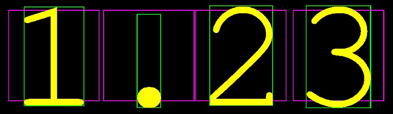

This illustrates the problem with using a method of "boxing" the text:
TheGreen Boxes are those obtained using the geometric extents of the symbol in the text, and the Magenta lines are 1.0 x 1.0 squares, with X-Coordinate centered using the Green boxes.
The Textsize is 1.0
Notice that there are uneven spaces between the characters, making it difficult to get an exact distance to the decimal point.

You can always force to true monospaced font. -David
Great idea David! I'd got hooked on Courier New...
