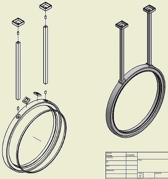

Here are a couple of examples of how Inventor is laid out. You really don't have to create viewports just drop in plan or isometric view and arrange them any way you like without having to worry about overlapping your vports or having to move or create additional.

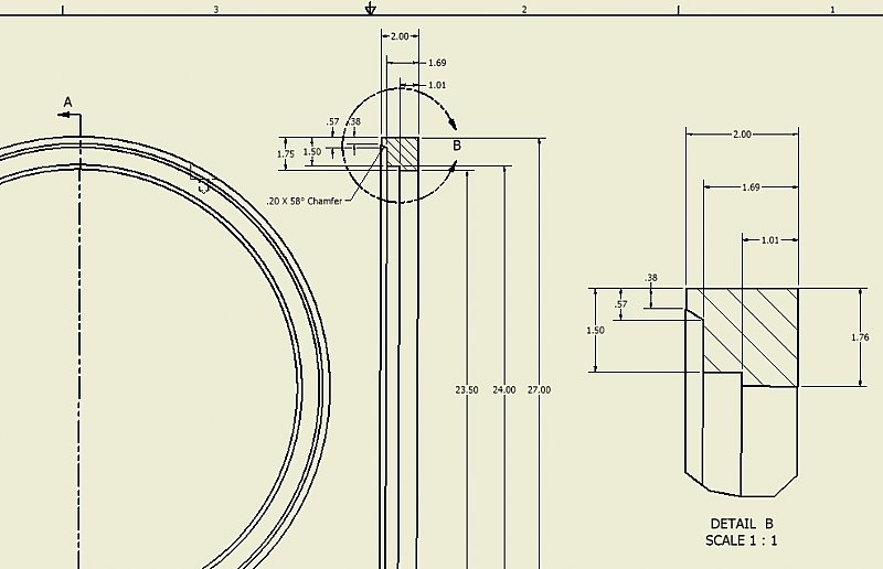

Inventor creates the detail views for you just select the view and draw a circle around the object and it creates cut lines and the detail text for you.
Section views are a breeze. No creating section planes or drawing polyline variable width arrows and center lines. just pick the view draw one line where you want the section and Inventor cut's it for you, creates the hatching, and writes the text. In the above example I created the section view then created the detail view from the sectioned detail.
Also, something nice about inventor is you can create blow-up views pretty easily and automatically which you would really have to struggle in AutoCAD. This last comparison is not really fair because Inventor uses the constraints from your model to create the view.
I am not dissing AutoCAD in any way, and I really like doing 3D in AutoCAD but it's getting harder to justify when there are programs like inventor out their.

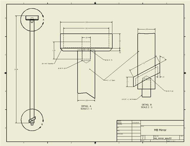

Here is another example. I created the same part in Inventor Then in AutoCAD. Inventor was easier but AutoCAD is still fun...
Inventor
Autocad
