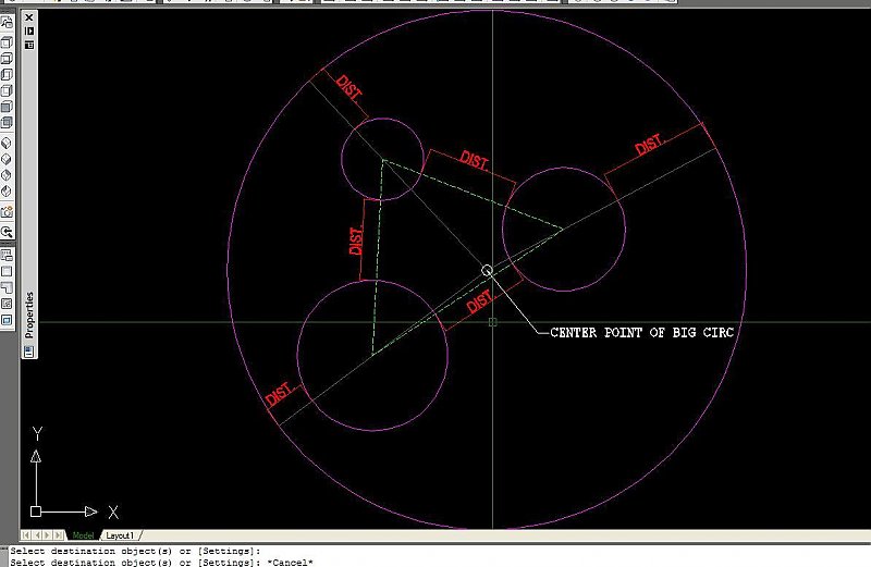

Heres an ugly way to do it: :lol:

Yes that does look very ugly. Does it really work?
You're supposed to tell me if it works :P
Nice work Geobuilder! The video is excellent too.
I just can't read the Russian menu pop-up! :wink:
I would just draw lines between the centers of the circles and trimmed using the circle as the cutting plane. The line your left with is the shortest distance between them.
Thanks Tankman
