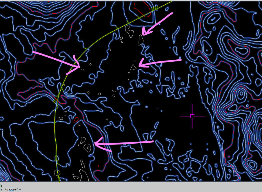

this comes very close. the only thing it seems to miss is if there are radius fillets in the polyline, it misses items that are within that arc. For example, see the chosen polyline in yellow and items missed pointed out in pink.
Lee Mac messaged me this example which also misses items within a radius fillet. But getting this far still saves me a lot of time on this big topography project I'm working on.
My lisp take that issue into account. Your pointing to the gray items? are they part of a block or xref?
I would have to see the file to tell you exactly why they aren't being selected but it works with arcs.

They are not a block or xref, it's just not selecting them. Example file available here https://1drv.ms/u/s!AklbmHoHc-lgvf4QZgr0pZh9RPvMIQ?e=ipFQdv
there are three problems.
1. for things to be selected with ssget "wp" and "cp" it needs to be on screen. So you have to zoom to object (yellow polyline) to make sure everything inside will be selected.
2. what (SELECTINSIDE ent 100) essentially does is splits up a polyline into 100 smaller sections. and since the polyline your running it on has 743 vertices already its making it less accurate rather then more. update (SELECTINSIDE ent 2000)
3. ssget has a limit on how many points can be inputted. and how many selected entity's can be listed.
That still doesn't fix the problem. when i ran the updated code i got over 35k+ entity's in the selection set. I moved them to another location outside the polyline and ran it again. and got the rest of the items inside.
Seems their is only 6 entity's not inside that polyline.
tldr
update code to (SELECTINSIDE ent 2000)
make your perimeter polyline smaller,   or move the items selected entity's to another location outside the perimeter and run a second or even third time.
