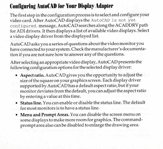

dbroada Posted January 11, 2010 Posted January 11, 2010 remember the pre R14 installation process? "Now draw a circle and measure it before running setup" Quote
ReMark Posted January 11, 2010 Posted January 11, 2010 Now that you mention it only vaguely. Want to refresh my memory? I haven't had my 10 cups of coffee yet. Just starting on cup 2. Quote
dbroada Posted January 11, 2010 Posted January 11, 2010 only a vague recollection..... there was a dos set up prog you ran and had to type in the X & Y measurements of a circle. The screen was then adjusted so that the circle was round. that would then modify your acad configuration files so that you always had a circle Quote
ReMark Posted January 11, 2010 Posted January 11, 2010 Ah...the good old days of DOS. Look how far we have progressed. Are you suggesting that the OP needs to do this? I thought those days were long gone. Quote
dbroada Posted January 11, 2010 Posted January 11, 2010 I don't think you would want to these days. If it is THAT bad I would adjust the screen either from the video card set up page or on the screen buttons, however from our old book.... Quote

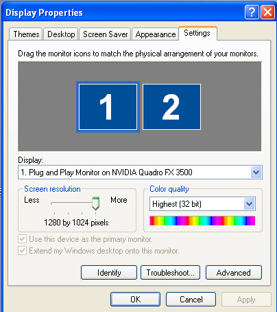

JD Mather Posted January 11, 2010 Posted January 11, 2010 Gotchy, Post a screen shot of your display settings something like attached. Quote
