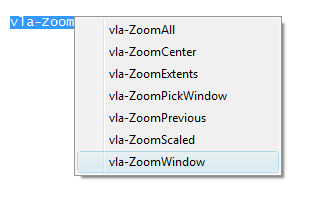

You're welcome Ollie, you may want to try also doing a (vla-zoom.. to make it visible on screen..
Nice thought, sadly the function doesn't exist. I've been trhough the document object model relentlessly trying to find a method of zooming through vla- without even a glimpse of hope
vla-ZoomExtents
vla-ZoomCenter
vla-ZoomAll..
There are tons...
vla-ZoomExtents
vla-ZoomCenter
vla-ZoomAll..
There are tons...
