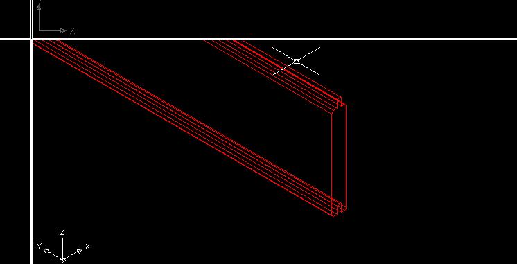

waxe Posted December 29, 2009 Share Posted December 29, 2009 Hi Guys! I am looking for a kind of LISP which will measure me the gross volume of 3d objects. As an example please see picture of wooden board attached. I need to extract dimensions of piece of wood in which I cut out the shape of board. Basically I need a toll which can give me in fact: max''X'', max ''Y'' and max ''Z'' dimensions. Usually ACad is measuring net volume in standard tool ''Phisical parameters''. Thanks for any advise! Phedaar Quote Link to comment Share on other sites More sharing options...
ReMark Posted December 29, 2009 Share Posted December 29, 2009 I'm not familiar with a tool in AutoCAD 2006 called Phisical parameters. How is it accessed? You're not referring to the MassProp command are you? Quote Link to comment Share on other sites More sharing options...
wizman Posted December 29, 2009 Share Posted December 29, 2009 Please try: ;; ;; (defun c:dim3dbox (/ ent maxpt minpt obj originpt alldelta) (vl-load-com) (if (setq ent (entsel "\n>>>...Pick 3d Object on its X-axis...>>>: ")) (progn (setvar 'cmdecho 0) (command "._ucs" "_f" (osnap (cadr ent) "_NEA") "") (setq ent (entmakex (entget (car ent)))) (setq originpt (trans '(0 0 0) 0 1)) (vla-TransformBy (setq obj (vlax-ename->vla-object ent)) (vlax-tmatrix (list (append (getvar 'ucsxdir) (list (car originpt))) (append (getvar 'ucsydir) (list (cadr originpt))) (append (trans '(0 0 1) 1 0 t) (list (caddr originpt))) '(0 0 0 1) ) ;_ list ) ;_ vlax-tmatrix ) ;_ vla-TransformBy (vla-getboundingbox obj 'minpt 'maxpt) (vla-delete obj) (grdraw '(0. 0. 0.) (polar '(0. 0. 0.) (* PI (/ 0 180.0)) (/ (getvar "viewsize") 10) ) ;_ polar 1 ) ;_ grdraw (grdraw '(0. 0. 0.) (polar '(0. 0. 0.) (* PI (/ 90 180.0)) (/ (getvar "viewsize") 10) ) ;_ polar 3 ) ;_ grdraw (command "._ucs" "_p") (setvar 'cmdecho 1) ;; ;; (alert (strcat (vl-princ-to-string (apply 'mapcar (cons 'strcat (list '("delta X= " "delta Y= " "delta Z= ") (mapcar 'rtos (setq alldelta (apply 'mapcar (cons '- (mapcar 'vlax-safearray->list (list maxpt minpt) ) ;_ mapcar ) ;_ cons ) ;_ apply ) ;_ setq ) ;_ mapcar ) ;_ list ) ;_ cons ) ;_ apply ) ;_ vl-princ-to-string (strcat "\n Volume= " (rtos (apply '* alldelta) 2 3 ) ;_ rtos " cu. units" ) ;_ strcat ) ;_ strcat ) ;_ alert ;; ;; ) ;_ progn ) ;_ if ;; ;; (princ) ) ;_ defun ;; ;; WIZ_30DEC09 Quote Link to comment Share on other sites More sharing options...

waxe Posted December 30, 2009 Author Share Posted December 30, 2009 WizzMan, that is absolutely perfect! Thanks! Quote Link to comment Share on other sites More sharing options...
SEANT Posted December 30, 2009 Share Posted December 30, 2009 Once again, lisp wizards demonstrate code that is exceptional terse and efficient. I posted similar VBA code in this thread (http://www.cadtutor.net/forum/showthread.php?t=37494) which required 50% more lines of code and probably 3 times more actual typing. In that thread I brought up the notion that Autodesk may not be eager to see this type of functionality available to vanilla AutoCAD. Perhaps even to the extent that they hamper the effort. I think your lisp routine here, wizman, is falling victim to the same discrepancy that plagued my original routine posted there. See the attached dwg. SqRod.dwg Quote Link to comment Share on other sites More sharing options...
wizman Posted December 30, 2009 Share Posted December 30, 2009 Thank you for your information Seant. i shall investigate it. it seems correction is needed when solids are rotated in space (having z rotation) Quote Link to comment Share on other sites More sharing options...
wizman Posted December 30, 2009 Share Posted December 30, 2009 I updated code above ...'-) Quote Link to comment Share on other sites More sharing options...
waxe Posted December 30, 2009 Author Share Posted December 30, 2009 I updated code above ...'-) Wizman, Could you please insert updated code? Would it be possible to mark the group of objects in your LISP? For now I can mark only one to get the volume.. What I am looking for is to get the measurement of (Xmax, Ymax,Zmax) e.g. 4-5 different 3d objects. thanks ! Quote Link to comment Share on other sites More sharing options...
wizman Posted December 30, 2009 Share Posted December 30, 2009 the updated code is on my first post. Quote Link to comment Share on other sites More sharing options...
SEANT Posted December 30, 2009 Share Posted December 30, 2009 That was a quick fix. Nicely done. Quote Link to comment Share on other sites More sharing options...
wizman Posted December 31, 2009 Share Posted December 31, 2009 That was a quick fix. Nicely done. Thank you Seant... As for the OP request to make it work on selections of 3dSolids, I think this method is only applicable to one by one pick since it uses the pickpoint to align the ucs to a an object. It can be made work with selections sets but only by using ssget ":E" and ssnamex whick is also a manual pick on each one. Quote Link to comment Share on other sites More sharing options...
