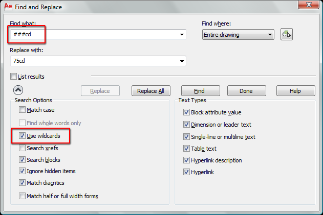

Fire Alarm Posted December 29, 2009 Posted December 29, 2009 I have search and can not seem to find a lisp. Hopefully yall will be able to help me. I am looking for a AutoLisp that will find and replace multiple text. For example if I have a string of text like 75cd, 15cd, 30cd, 30cd, 110cd, and I need everything to read 75cd. Instead of doing the find and replace command four times, or editing each attribute/text individually I would like to have it find all the 15's, 30's, & 110's and replace them with 75 at the same time. Thanks for taking to the time to help. Quote
ReMark Posted December 29, 2009 Posted December 29, 2009 Take a look at this. http://www.cadtutor.net/forum/showthread.php?t=35933 If you use the tfind.lsp on page 1 combined with the newfun.lsp on page 3 (substituting your own parameters) you'll obtain the desired results. You can thank forum member Freerefill for the code afterwards. Quote

ReMark Posted December 29, 2009 Posted December 29, 2009 Would work with a three digit sequence Lee but would it also work for a two digit sequence as well and at the same time? Quote
Fire Alarm Posted December 29, 2009 Author Posted December 29, 2009 Works perfectly. You need to change your name to Lee Mac Daddy. Cause your awesome. Quote

Lee Mac Posted December 29, 2009 Posted December 29, 2009 Would work with a three digit sequence Lee but would it also work for a two digit sequence as well and at the same time? Well, you could always run it three times with "###" "####" and "##", quicker than the alternative. Works perfectly. You need to change your name to Lee Mac Daddy. Cause your awesome. Haha thanks dude. _____________________________ After looking at Freerefill's code, I must say that it is coded in a very unconventional way (using an imaginary "GoTo" statement), and it could probably be made to run a lot faster. But to be completely honest, I don't see that Freerefill's code has any advantage over the improved FIND command that comes with 2010 - now that you have the additional options, it has much more versatility. As for your explanation Mark, yes, you are correct - tfindfun is a subfunction that requires three arguments (old string, new string and mode flag I believe), these can be entered straight into the command line, example: (tfindfun "old" "new" 1) Or, you can create a new function to call the subfunction, as shown by the newfun function. I might add that the filename.lsp need not be identical to the function syntax of these codes, in case you were unaware. Lee Quote

ReMark Posted December 30, 2009 Posted December 30, 2009 My bad. Seems I neglected to really look at the Find pop-up window. Specifically the lower left-hand corner and the More Options arrow. I'm using 2009 at the moment. Click on the arrow and see exactly what Lee Mac has depicted in the image above. Once I was blind. I guess I still am. Need coffee now. Quote
