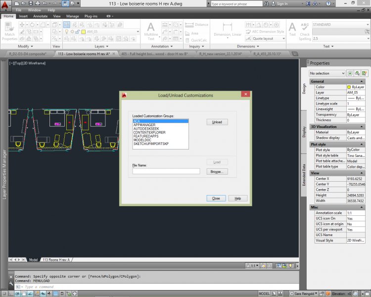

ReMark Posted May 29, 2014 Share Posted May 29, 2014 Access the Text screen by pressing the F2 function key. Have you tried MENULOAD? Quote Link to comment Share on other sites More sharing options...
Sbeth85 Posted May 29, 2014 Share Posted May 29, 2014 I pushed F2 and see a screen with lots of text... I checked near the top and there's nothing about forgetting to load DLLs... I put in the command MENULOAD- now what? Quote Link to comment Share on other sites More sharing options...

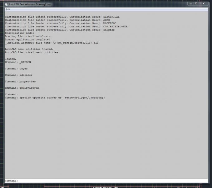

ReMark Posted May 29, 2014 Share Posted May 29, 2014 First, I don't see where Express Tools has been loaded. If it had been loaded the word EXPRESS would appear on the list. You could use the Browse button to migrate to where the .exe file is for Express Tools and try loading it. Second, are you using a custom CUIx? Quote Link to comment Share on other sites More sharing options...

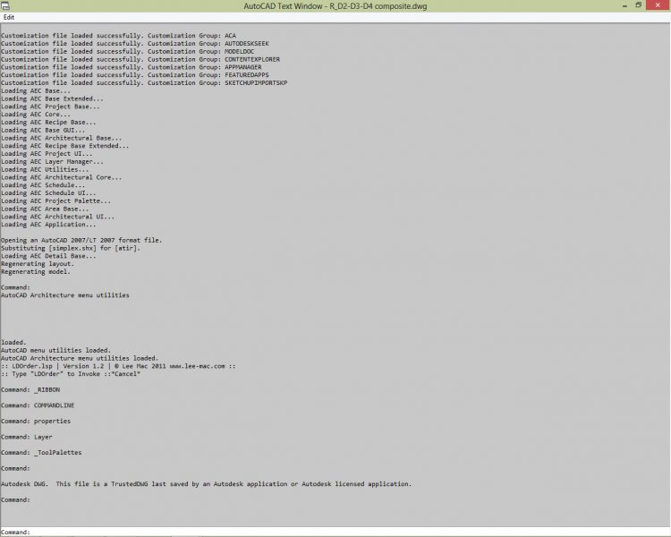

Sbeth85 Posted May 29, 2014 Share Posted May 29, 2014 dboarda- I rebooted and pressed F2, here it is: Quote Link to comment Share on other sites More sharing options...
ReMark Posted May 29, 2014 Share Posted May 29, 2014 So you are running AutoCAD Architecture not plain AutoCAD? You should change your Profile so we know the actual program you are using. In some cases it may make a difference. Quote Link to comment Share on other sites More sharing options...
