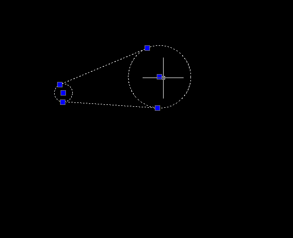

LEsq Posted December 20, 2009 Posted December 20, 2009 Just finish a quick custom object, to show a different approach. Quote
wizman Posted December 20, 2009 Posted December 20, 2009 good code lee, thank you for sharing. LE is that the tangential geometric constraint in ACAD_2010?. Quote
Lee Mac Posted December 20, 2009 Author Posted December 20, 2009 Thanks Wizman, and very, very nice LE! I wish I knew more than just LISP Quote
