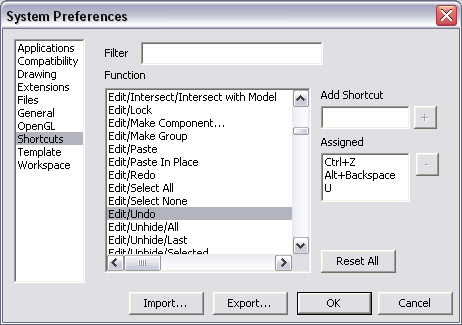

boofredlay Posted December 18, 2009 Share Posted December 18, 2009 Ha ha, that made me laugh. Sorry but it did. Unfortunately SU does not have a native mirror command. You would think that something as basic as that would be standard. There is a Mirror Plugin however. I use it probably more than any other Plugin except for maybe Weld. Both are free. Here is Mirror3.1 Scroll down, it is in alphabetical order. Here is Weld Quote Link to comment Share on other sites More sharing options...
Sparky Posted December 21, 2009 Author Share Posted December 21, 2009 Yea I understand. I work with AutoCAD every day and Sketchup is a whole new animal. I find myself hitting "U" for undo every time I use Sketchup, old habbits die hard. I do use the standard keyboard short cuts for push/pull, erase, etc. Thanks for the plugin, it works great! Merry Christmas! Quote Link to comment Share on other sites More sharing options...
boofredlay Posted December 21, 2009 Share Posted December 21, 2009 Your welcome. You know you can set your own shortcuts in SU as well. I have Undo set as "U" as I also came from an Autocad background. Just go to Window / Preferences and you can add your own there. Quote Link to comment Share on other sites More sharing options...
Sparky Posted December 22, 2009 Author Share Posted December 22, 2009 That's awesome! I took a sketchup class in college but it was not very in depth. Thanks! Quote Link to comment Share on other sites More sharing options...

designerstuart Posted June 30, 2010 Share Posted June 30, 2010 also, bear in mind you can 'mirror' by scaling with a factor of -1. either in one axis, two, or all 3. i use this more than flip along. SU has a handy feature where it snaps to certain scale factors like 1,-1, 2, etc. @boofredlay - agree - i set all my autocad aliases to match my sketchup shortcuts. i need consistancy! Quote Link to comment Share on other sites More sharing options...
