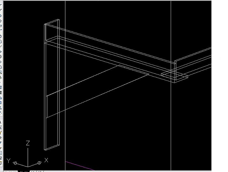

dreamer Posted December 16, 2009 Posted December 16, 2009 Visual Style: Conceptual Hi, I can not understand why my objects seems somewhat transparent - the lines behind should not be visible. Help please. Thank you in advance. Quote

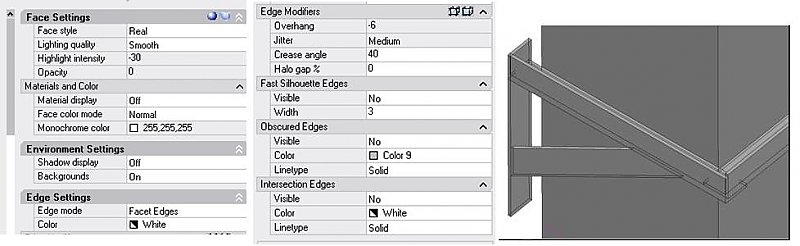

ReMark Posted December 16, 2009 Posted December 16, 2009 Try setting the variable VSOBSCUREDEDGES to 1 and see if that helps at all. Quote
dreamer Posted December 16, 2009 Author Posted December 16, 2009 No, only where the lines should be invisbile changed to light grey colour Quote

iskalipsi Posted December 16, 2009 Posted December 16, 2009 they may be overlapping solids, try to check your drawing in the wireframe if they don't intersect. Quote
ReMark Posted December 16, 2009 Posted December 16, 2009 Is DISPSILH set to 1? What is ISOLINES set at (the default is 4)? Set this to 0. Try setting VSEDGES to 0. Quote
