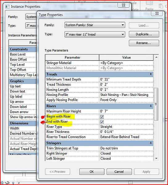

I am drawing a two storey building with a round staircase, I have tried to insert the staircase but it will not work. I have selected the ground and first floors, I have chosen the number of risers, their rise and going and the width of the stairs. The staircase is appearing in my drawing but it only has ten steps and does not reach my second floor level. Can anyone tell me if there are anything I am doing wrong and what should I check to try and solve the problem.

Are you just barely missing the second floor by about one riser, +/- a few inches?
Got a pic you can post?
If your close, then check out the rise type property of the stair (please refer to attached image.)
