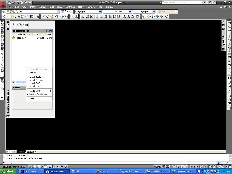

What version of cad are you using?Attach your image in externalreferences command or "ER"
I am using 2009. I will try both.
thanks

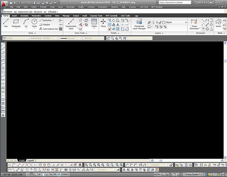

Wheres your ribbon ???? :D Autodesk whats you to use your ribbon. :lol:
I'm not used to using ribbons :D
I'm using a hybrid of sorts. I am finding myself using the ribbon more and more this way
